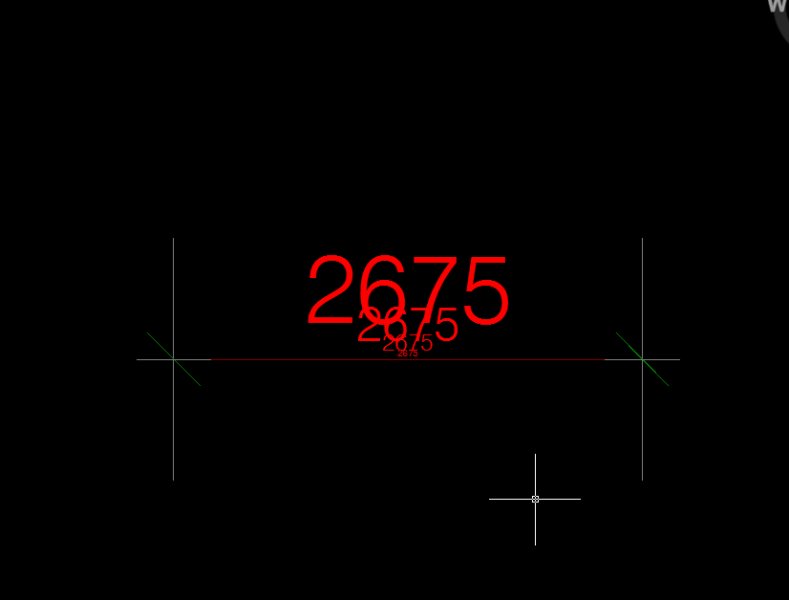

mrfitzgerald Posted November 28, 2012 Posted November 28, 2012 Hello all Hope someone can help or point me in the right direction. I've completed my drawing (Autocad architectural 2012) and set-up my multiple view-ports (at 1:50 and 1:5 scale) on my title-block. I'm now going to add my text and dimensions im model space....and that's when the problems start! I've created text and dimensions in annotative style. The issue I have is when I change annotation scale from 1:50 to 1:5 my text and dimensions in model space automatically changes (as can be seen on attachment) to a huge scale but is perfect in layout view for differing scales. Can anyone offer help as to what I am doing wrong? Thanks in advance of any help and advice. Mark Autocad 2012.pdf Quote
KiLLiNG-TiME Posted November 28, 2012 Posted November 28, 2012 Just a guess, but by looking at your icons id say you have autoscale turned on & show objects in all scales on & you have ended up with what i have in the picture, try turning autoscale off & show annotations in all scales off & see what happens. Quote
KiLLiNG-TiME Posted November 28, 2012 Posted November 28, 2012 Aaahhh sorry for huge picture ! ps i think your not doing anything wrong its just how you have set things up to display in model space. Quote

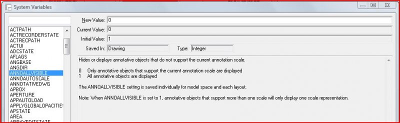

ReMark Posted November 28, 2012 Posted November 28, 2012 Try this: change the value of SELECTIONANNODISPLAY to a value of "0". Quote
KiLLiNG-TiME Posted November 28, 2012 Posted November 28, 2012 Try this: change the value of SELECTIONANNODISPLAY to a value of "0". Yep that will work as too (i dislike autoscale myself as i like to control my annotations myself but like all things its a choice) Quote

KiLLiNG-TiME Posted December 5, 2012 Posted December 5, 2012 Your annotating different size MT text that is stacked, in layout1 if you unlock the main (top) viewport & pan up you will see all the MT txt with the issues @ 1:50. Quote
rkent Posted December 5, 2012 Posted December 5, 2012 You will want to not assign 1:50 to the text and dims on the details for the obvious reasons. You can select them all, sort by mtext, etc, and delete the scales you don't need for the details. Turn off the ANNNOAUTOSCALE from now on unless you know for sure you want it on. You will not have the same size (displayed) text in MS, just in PS when the views are set to their scales, that is how it works. Quote
