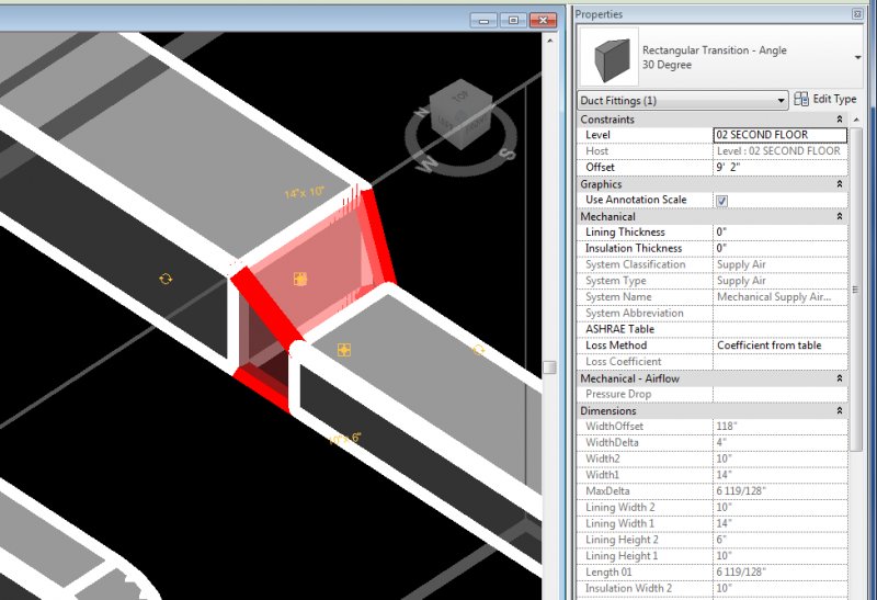

Nick-H- Posted November 29, 2012 Author Posted November 29, 2012 Select the Transition, and in Properties adjust the "OffsetWidth" input. I tried that and it didnt work but now I have just realised. Do you have to have the family loaded in? Quote
tzframpton Posted November 29, 2012 Posted November 29, 2012 I tried that and it didnt work but now I have just realised. Do you have to have the family loaded in? Yes, without the Families then you can't use the correct fitting. Just load all the Families under the Transitions folder and try each one to see if it fits your needs best in your duct layout. Quote

RobDraw Posted November 29, 2012 Posted November 29, 2012 The offset functionality is built into the rectangular angled transition. Use the method I described earlier to model it. Quote

Nick-H- Posted November 29, 2012 Author Posted November 29, 2012 The offset functionality is built into the rectangular angled transition. [ATTACH=CONFIG]38908[/ATTACH] Use the method I described earlier to model it. I dont seem to have any transitions in my familes :S do I have to create one? Quote
Lee Roy Posted November 29, 2012 Posted November 29, 2012 \US Imperial\Duct\Fittings\Rectangular\Transitions Quote
Nick-H- Posted November 29, 2012 Author Posted November 29, 2012 \US Imperial\Duct\Fittings\Rectangular\Transitions I dont have that ive got transformations but it just transforms on either side and not just one Quote
Lee Roy Posted November 29, 2012 Posted November 29, 2012 What version are you using? From Revit MEP 2009 to Revit 2013, my transitions are in the same folder tree for each version. Quote
Nick-H- Posted November 29, 2012 Author Posted November 29, 2012 Done it at last... God knows what i was doing wrong Quote
