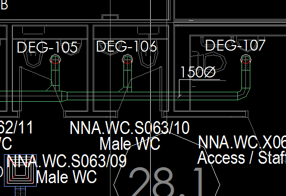

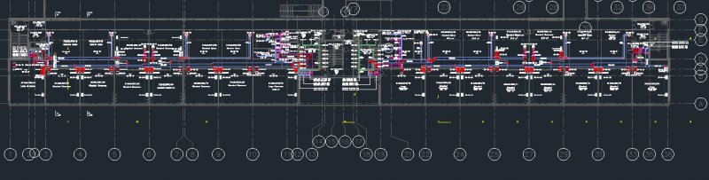

Nick-H- Posted November 27, 2012 Posted November 27, 2012 I have been asked if I model some drawings from 2d autocad files, into a revit model. is there any way of inserting the cad files into the revit model and tracing over the ductwork. I have seen it done before but im not sure how I do it myself. and bare in mind ive not really used revit mep to create any project before so im quite new at all this. the person who wants this doing says the finished ductwork and containment doesnt have to be 100% accurate as it is just going to be used as a marketing tool. I would be greatful if someone could give me some guidance Nick Quote
RobDraw Posted November 27, 2012 Posted November 27, 2012 (edited) Go to the "Insert" tab to "Link CAD". If the Revit model and the CAD dwg are coordinated, use the "Origin to Origin" option for "Postioning". If not use which option seems best for you and adjust the postioning manually after you insert, if needed. Edited November 28, 2012 by RobDraw Quote

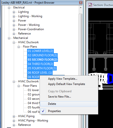

RobDraw Posted November 27, 2012 Posted November 27, 2012 Audit, delete schedules, legends, sheets, unneeded views, and Purge Unused. Views can be deleted in groups by the branches of the browser tree (see attached). Clean-up is not necessary. I do it because it reduces file size dramatically. Your results may be different depending on the model. Quote

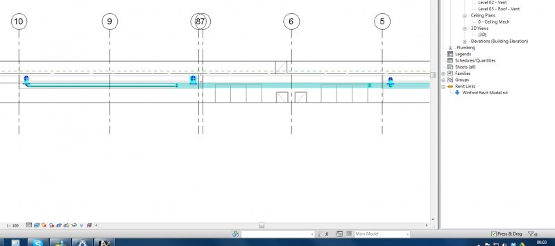

Nick-H- Posted November 27, 2012 Author Posted November 27, 2012 Cheers for that I have managed to not delete stuff I dont want.. How do I go about creating HVAC views, so I can draw ductwork on the floor plans (or trace ductwork from the 2d) Cheers Quote
RobDraw Posted November 27, 2012 Posted November 27, 2012 Since the model is from an outside source and may be subject to change, I would start a new project and link that model into your project. It will make it extremely easy to update the linked file if there are changes. To make views, go to the View tab and click the Plan Views button. Quote

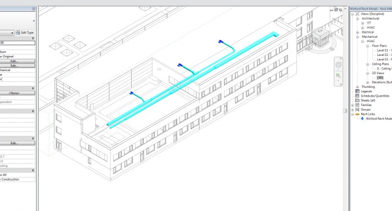

Nick-H- Posted November 28, 2012 Author Posted November 28, 2012 This is how far i got after cleaning the revit file. and linking it into a new project... now time to sleep Quote

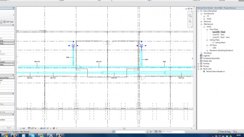

Nick-H- Posted November 28, 2012 Author Posted November 28, 2012 How do you make rectangle duct reduce on one side only instead of both? Cheers for the help so far. Nick Quote
tzframpton Posted November 28, 2012 Posted November 28, 2012 Select the Transition, and in Properties adjust the "OffsetWidth" input. Quote
RobDraw Posted November 28, 2012 Posted November 28, 2012 If you draw both ducts and move one so that one side of each duct is lined up and then stretch one duct to the other it "should" give you what you want. Quote
