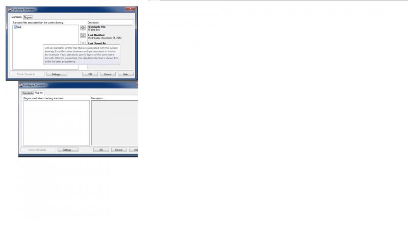

I am having problems with my check standards is saying i need to run it with plug-ins. when i switch over to the "plug-ins" tab, nothing is there to select. do I create the plug-ins? if so, how?
Never used STANDARDS personally, but as I understand it, the (or at least some) plug-ins are provided OOTB (i.e., Dimension Styles, Layers, Linetpyes, and Text Styles).
Is it possible that you're missing one or more Support File Search Paths (SFSP)? Compare your profile to that of the OOTB profile(s) to see if you are, and to make sure the plug-ins show up in a non-customized profile.
Im not sure what you mean by if its missing SFSP. Or how to compare my profile to the OOTB. Standards are made just like templates, instead of a dwt it is a dws. Usually you attach them to a drawing through the STANDARD command and then use them through the CHECK STANDARDS command. From what I have read in the AutoDesk help, Plug-ins are used to save time by checking only parts of the drawing (ie, Only check layers and Dimstyles, or Only Layers, etc) I have used this many times and never needed to specify a plug-in and now that it is asking me to, there is nothing to specify in the plug-in box. It is empty. So I cannot run the standard at all.

Im really not sure where i would find the OOTB and SFSP locations. But here is my configuration box4.jpg
the bottom picture is the plug-ins box after i have loaded my dws. It is blank. I watched a tutorial on this and when the user opened the standards on the configuration, the plug-ins were there.

Options Command, Files tab, Support File Search Path node :wink:
What I am saying, is that I suspect that there may be a path missing, one where the plug-ins reside, that due to it (this path) potentially being missing from your SFSP, precludes these plug-ins from being loaded when you start AutoCAD, and thus showing you no available plug-ins when you get to the dialog.

Well i found the solution so i will put it on here. basically I had to go to my control panel to "programs and features" to autocad to "add remove features". I unchecked the "standards" box and updated. Then rechecked the box and updated again. Its all working again.:)
