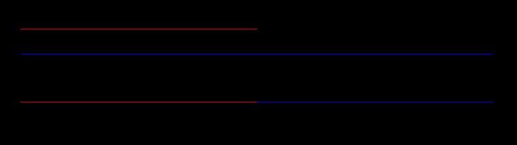

Thanks to anyone who can and want to help:
Do not know if I've put this question, or like, another time: Following the principle of this simple routine, I intend to expand it to a more global task, allowing within a range of lines (not just selecting one by one), are new lines drawn between the points of overlap. To better understand an image attachment.
Your routine would trim out the overlapping portion of both lines then add a line segment between the two existing lines. Wouldn't it be more efficient to get the total length of the two overlapping lines and substitute one line for them both?
ReMark,
I appreciate the interest.
For the purpose I want, even if the idea is to create new lines in overlapping segments. It is not necessary to cut the common thread or join in a single line.
But wouldn't that just create another overlapping object? I would think you would try to avoid that situation. What is the purpose then of the new line (the yellow one in your example)?
In this case demonstrate the overlapping segments and demonstrate that printing with a third color.
Might I suggest that overlapping lines be circled instead? That would facilitate finding them so the user could go back and correct their mistakes.

The above simply creates a third line between the endpoints of the overlapping lines, however, the result could easily be highlighted by other means if necessary.

However, for the purpose of specifically, this routine and the result will, at the level of printing, represent overlapping elements by using a different color
I simply viewed the thread as solving a geometrical problem - I'll leave the CAD drafting practices to the OP :thumbsup:
Lee,
That's it. As I explained, it may seem unusual, but in this case it is a specific need.
I appreciate the help and the routine. It exctamente that he needed. Thank you for the fantastic help.
By the way, what other options outstanding have in mind? It would be enriching for the routine can consider them as an option.
However, how to prevent small variations in the value of each coordinate coincident, it is not necessary to define a greater number of decimal places? Also note that in the case of coinciding rows in end points, lines are created with zero length. Not very relevant, but perhaps it would be preferable to eliminate or not considering.
I note also that in a situation where the ends point is coincident lines in two partially overlapped, as in the attached drawing, the routine is not drawing.

I tested the routine in different situations, and works match I want. However, in similar situations, some are resolved and others not. Will these unresolved situations in which, apparently, such lines are created with zero length.
I admit that when I put the request for help, does not include the variant lines can be matched one or both ends, and this is also important, if possible, of course.
With time, I appreciate the help to resolve this apparent inconsistency.
DWG file is attached to aid understanding of the situation that occurs.
Tanks for the help!
cadtutor_exp_overlap_1.dwg
This will avoid the zero-length lines:

You just solved the issue of zero-length lines as well as the question explained that through the DWG file.
Provisional and partly I was to solve the problem by doubling the routine, and inverting the assoc values.:D
