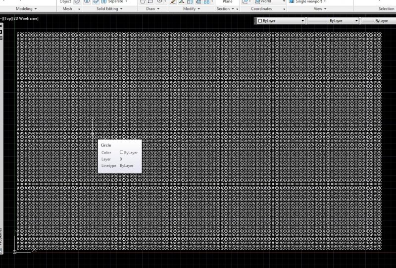

While this is a very logical statement I doubt any modern computer will be phased by the difference. Or at least it will not be noticeable by a human eye.
As a test a drew a circle, ran an array command and achieved 11,016 circles in Acad 2013.
I exploded the array so I had individual circles.
I set viewres to 2,000 and typed regen. Instant regen.
I set viewres to 15,000 and typed regen. Instant regen, no delay at all.
My system monitor I run showed no difference between the settings.
Sure different PCs with different setups will and can yield different results I see no difference what so ever on my PC at work.
I might try this at home and see what happens there.
Whipthread was set to 1 during the above test. I set it to 3 and still response feedback was instant.
