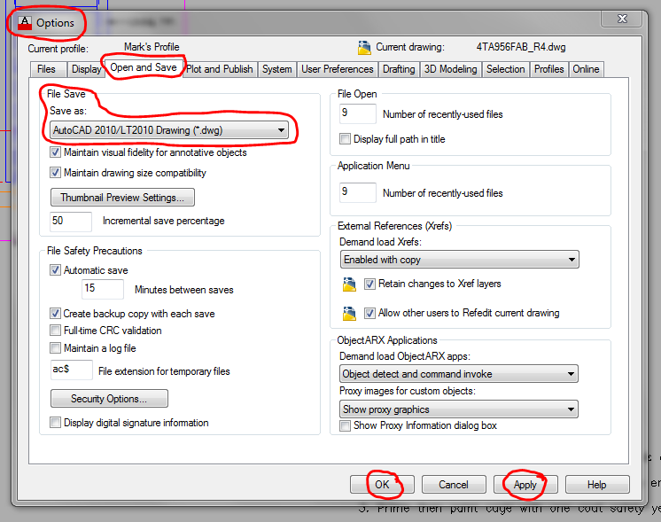

ReMark Posted November 26, 2012 Posted November 26, 2012 The reason you can no longer open the drawing in 2012 is that when you worked on it at home you saved to the 2013 DWG standard not the 2010 standard which AutoCAD 2012 supports. Quote
skybhoy Posted November 26, 2012 Author Posted November 26, 2012 anyway i could get it to work in 2012 again? Quote
ReMark Posted November 26, 2012 Posted November 26, 2012 Yes. Open it in 2013 and do a "save as" to the AutoCAD 2010/AutoCAD LT 2010 Drawing (*.dwg) file format. As long as you are going to be working on the dame drawing both at home and at school you should set your home version of AutoCAD to always save to the 2010 file format then you won't have these types of problems in the future. Quote

ReMark Posted November 26, 2012 Posted November 26, 2012 I'm sure you know how to do this so consider the attached image to be for those who might not know. Quote
