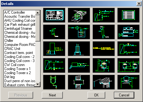

We have a set of toolbars and menus that contain viewing panes for multiple details/symbols etc, controlled by slides (*.sld files), I gather.
I have located the .sld files but cannot figure out how the viewing pane is constructed, how it writes the headings etc. Is there a seperate file that governs this (text file maybe), and where can I find it?

Its part of a mnu best way is write a partial menu and use Menuload to load it. The sld's may be either individual or in a SLB (library) its just a case of the name in your menu. Heres a sample working in just about any version of Autocad.
***MENUGROUP=BIGALSTDS
***POP15
**CADLIB
            [LIBRARY]
            [->Stddwgs]
            [TRENCH]$I=BIGALSTDS.TRENCH $I=*
            [<-PIPES]$I=BIGALSTDS.PIPES $I=*
***image
**TRENCH
[TRENCH]
[bIGALSLD(CGG101,KERB)]^C^C(openblk "P:/ACADSTDS/CIVIL STANDARDS/CGG101")
[bIGALSLD(CGG102,NATURE)]^C^C(openblk "P:/ACADSTDS/CIVIL STANDARDS/CGG102")
**PIPES
[PIPES]
[bIGALSLD(SD201,SUBSOIL)]^C^C(openblk "P:/ACADSTDS/CIVIL STANDARDS/CGG201")
[bIGALSLD(SD202,FLUSHOUT)]^C^C(openblk "P:/ACADSTDS/CIVIL STANDARDS/CGG202")
Thanks, I see the make up of it now in the menu file. Best get cracking on it.
