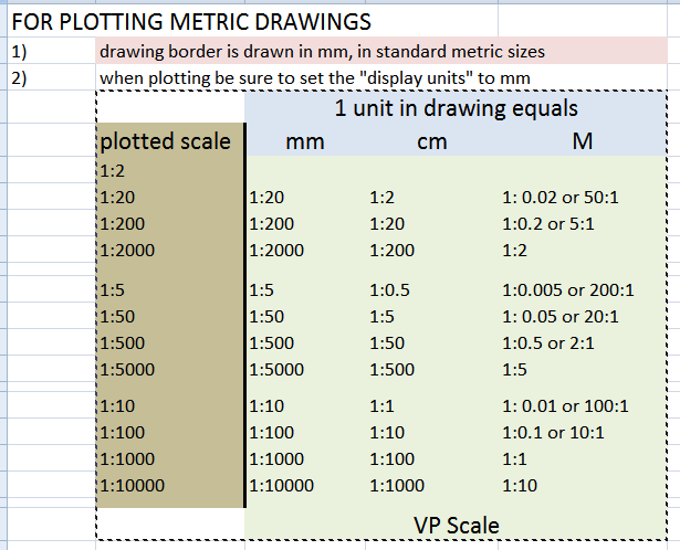

rkent Posted November 17, 2012 Posted November 17, 2012 Are you drawing in imperial or metric? If metric, are your units assumed to be mm, cm, or M? What dimensions did you make your border? Quote
The Farting Sloth Posted November 19, 2012 Author Posted November 19, 2012 I am using metric my units are mm. Quote
rkent Posted November 19, 2012 Posted November 19, 2012 (edited) To apply a scale factor or plotting scale in a viewport in a layout you can click once on the outline of the viewport, pick the vpscale from the lower right annoscale dropdown or use the mview toolbar . You can make that viewport active (double click inside the viewport) then use the scale list at the lower right part of the screen, or find the mview toolbar and pick the scale from there, or click on the viewport and use properties to set it, or go old school and type it in after starting the zoom command. So if you need a scale of 1:50 you simply pick that from the list of scales. (Old school you type Zoom, 1/50XP) It is best to center the area you are wanting to show using zoom and pan and then apply the scale factor. Don't forget to lock the viewport after getting the scale you want and getting things centered with the Pan command. After leaving the viewport and getting back into PS you can right click on the viewport and pick Display Locked, and pick yes or no. Edited November 19, 2012 by rkent corrected some info Quote

BIGAL Posted November 22, 2012 Posted November 22, 2012 A simpler method for metric if you have the viewports toolbar displayed when you go into the mview window a number will appear in the box this is current scale factor, so if you want 1:500 just type 2 in box 10 for 1:100 4 1:250. 1000/scale Quote
