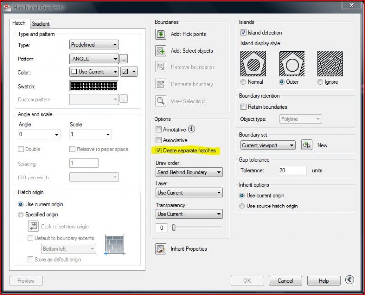

Easily remedied, on your HATCH DIALOG, as highlighted in the image.
I am assuming that this will be the same in LT.
I disagree with your answer Dadgad. The result of enabling "Create separate hatches" is that the user could erase the hatch pattern from one object while leaving other hatched objects intact even though all objects were hatched at the same time.
I believe the answer lies more with the boundary and whether or not the user has enabled the "Associative" feature.
I agree with ReMark that the create separate hatches controls the behavior of 2 hatches created at one time.
As far a I recall, if a hatch is associative the boundary polyline can be stretched and the hatch will continue to adapt to fill the polyline.
You can always elect to retain (or not retain) boundaries via Boundary Retention checkoff box.
What is your PICKSTYLE setting by the way? Mine is 3.
Right you are, reading comprehension running in extended sleep deprivation mode, very busy, time constrained. :beer:
