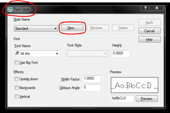

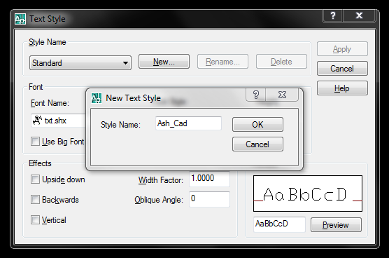

ReMark Posted November 14, 2012 Posted November 14, 2012 This is where it all starts re: new text style. Command: STYLE Quote

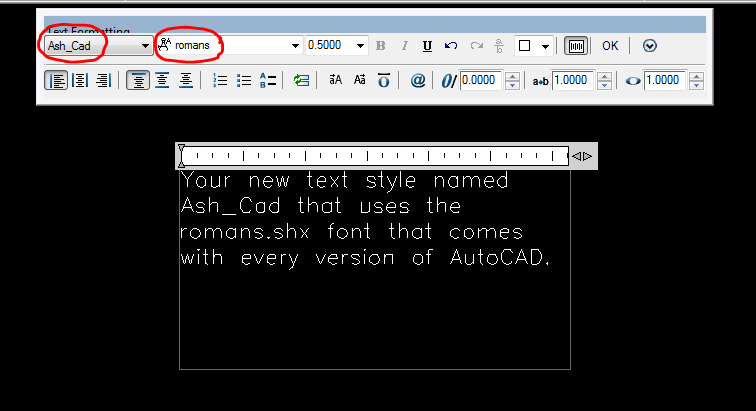

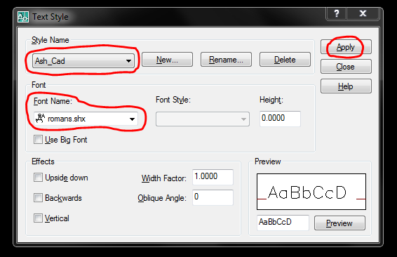

ReMark Posted November 14, 2012 Posted November 14, 2012 The final step. Testing. BTW...they are SHX fonts if you are talking about the ones that come with AutoCAD. The other available fonts are TTF (TrueType) and they ship with Windows. Let's try to keep our terminology in sync OK? Re: plotting. I think you are doing something wrong. Attach a copy of the DWG file you are using to your next post. Tell us exactly what you want to print and what size paper you want to print it to. If need be draw a rectangle around the area of the drawing you are interested in printing. Also tell us if it has to be to a particular scale or not. Quote

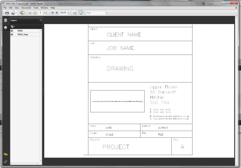

ASH_CAD Posted November 15, 2012 Author Posted November 15, 2012 Thanks for your effort ReMark If I open your version and simply Type > PLOT and change the What to plot to LAYOUT, I get the attached PDF. The title block is still not centre, which is my issue. Agree with the outer border BTW, more space the better. ASH_CAD-2-Layout2.pdfFetching info... Quote
