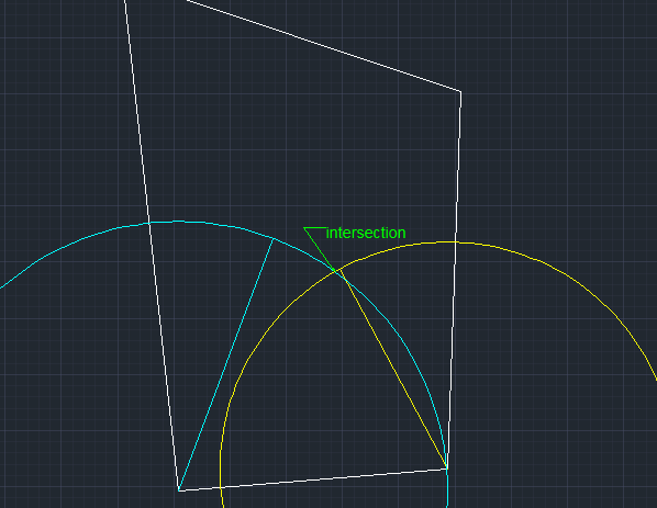

I didn't see the square you mention, but
create a circle with center at lower left intersection with radius to the upper endpoint of left red line. (I changed to blue)
create a circle with center at lower right intersection with radius to the upper endpoint of right red line. (I changed to yellow)
where the intersect is the location where the two lines would meet as the endpoints rotated around the arcs.
Edited by JD Mather
Thank you JD Mather... That's what i was looking for.
