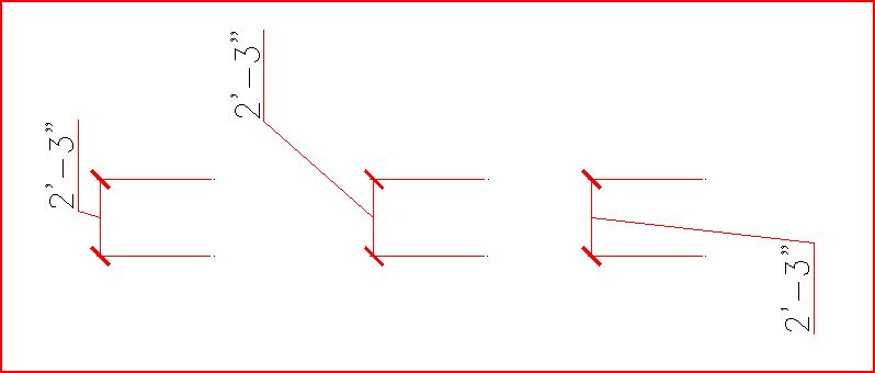

toberino Posted November 9, 2012 Share Posted November 9, 2012 Does anyone know of a way to automatically insert the arc like the picture? Is there a setting somewhere that will do this? Right now when we have a location that cannot accomodate the text we are drawing an arc and grip moving the dim text to the new location. I am trying to find a more automated way to handle these types of situations. Thanks Quote Link to comment Share on other sites More sharing options...
Dadgad Posted November 10, 2012 Share Posted November 10, 2012 (edited) Easily accomplished on the FIT tab of your DIMENSION STYLE MANAGER. Automatically creating a LEADER is easy, unfortunately you will not be able to make it an arc from the native options. It could probably be done with a lisp, if the leader being an arc is more important than the ease of creating a consistent leader quickly. Once created you can reposition the text with leader to an alternate position. Edited November 10, 2012 by Dadgad Quote Link to comment Share on other sites More sharing options...
