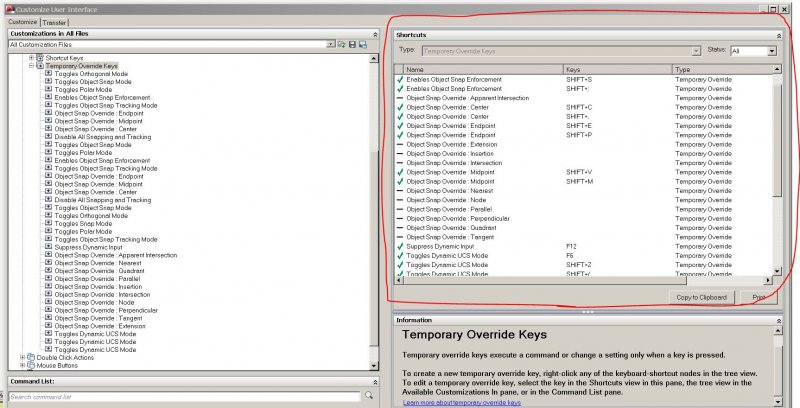

Those are already built into the OOTB CUI, open CUI, go to keyboard overrides, note what keys they are set to, leave the CUI and use those.
