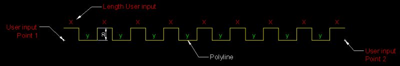

I am in a need for a lisp that can draw a specific polyline like shown below:
The user have to give:
1. User point 1 and 2.
2. Length X
About Lisp code:
The program the have to figure the out how to draw the Polyline, so i think it have to calculate the y length by it self.
Horisontal:
- If the user first give the user point 1 and the Point 2 then the lisp command
have to draw the Poly line like shown in the picture 1.
- If the user first give the user point 2 and the Point 1 then the lisp command
have to draw the Poly line like shown in the picture 2.
Vertical:
- If the user first give the user point 1 and then Point 2. the lisp command
have to draw it like shown on picture 3.
- If the user first give the user point 2 and then Point 1. the lisp command
have to draw it like shown on picture 4.
Why i need this:
I use the Polylines for a welding signatures on Flatpattern drawings so the welder/Blacksmith knows were he have to weld the x lenght when he/she weld a
Flatbar on a 'Flatpattern' plate.
Thanx in advance.

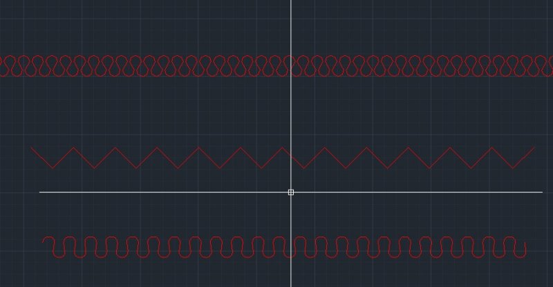

Looks like you need a new Linetype for that...not a lisp
Here is some very simple code:

Tha****:
- can you do some 'explanation what the code does. Then i could better understand the code and maybe change it.
- if you see my picture you will notice that the y is the horizontal line segment between the x line segments maybe i should have called it X1 one instead then there wasn't a misunderstanding there my fault... But any way the lisp code have to calculate the y line segment by itself.
- The code is asking for the y coordinates from the start point but in the pictures it says it always have to be 20mm.
- The first x line segment and the last x line segment have to have the same y-coordiantes like shown on the picture.
- The way that the poly turns direction depending on witch way the user gives the start and end point seams working..thanks!
Thanx forum members....
Here's a fun one for you to play with:
[color=GREEN];; Dynamic Zig-Zag  -  Lee Mac[/color]

Example:
Thanks Lee Mac ...but...it was not spot on.
I will try to explain again:
The User have to give the following:
- length of one of the horizontal x line segment. (Marked red)
- start point. (Marked red)
- end point. (Marked red)
1. The code have calculate the horizontal y line segments when the user have given start and end point. It not important how long y is. (Marked green)
2. At the start point it has to be a X line segment and just before endpoint there has to be a Horizontal X line segment.
3. The distance between X line segment and Y line segment is vertical always 20mm.
4. The poly line have to change direction according to the first post i write in this thread.
Thx in advance...Lee Mac.

You right about that the y line segment is very small. But i need the to change the code so the y line segment is calculate like in this example:
Let we say that the distance between the 1 point and 2 point is 160mm.
The weld length is 25mm. (X line segment)
Then code should calculate the y line segment to be 20mm.
Hope this help!
I have read...and...read...but i simple can't find the place to change the code please....please....help.
Unless I'm overlooking something obvious, by what relationship are you calculating the length of Y to be 20mm?
80% of X?
160/25 = 6.4, 6x25 = 150, 160-150 = 10, 10x2 = 20?
80% of X?
First i need to find out how many X line segments i need between the 2 points:
160/2 = 80 , 80/25 = 3.2 , (3+1) = 4 line segments.
Second i need to out how many Y line segments i need between the 2 points:
160/25 = 6,4 this i round off to 6, (6+1) - 4 line segments = 3 line segments.
This means that the length of y line segment is.
160-(4x25)=60 , 60/3=20mm.
Check if i am correct: (4*25)+(3*20) = 160mm. yes it fits.
I hope this helps....Thx lee mac.
