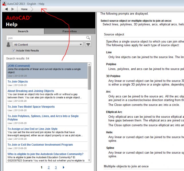

join command
does it make a difference if its a line or a poly line? in oder for this command to work?
line polyline spline arc - try it 1 minute exercise
Learn to use this screen and you will be the AutoCAD guru at your company.
We have a co-op drawing up some structural steel columns and he is having problems with the I-beams

Well now this is driving me crazy - I might have to get my notebook off the shelf...
something about Gap Tolerance.....
PEDIT command...
JOIN
Adds lines, arcs, or polylines to the end of an open polyline and removes the curve fitting from a curve-fit polyline.
