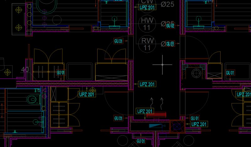

People I have an issue I haven’t seen before, I have a drawing from a company(structural) now it’s a dwg (not sure if originally drawn in AutoCAD at moment) when I open it I can see everything fine, but when referenced in to another drawingcertain parts are only visibly when clicking on the xref or when panning ...it’s doing myhead in :? any help would be great thank you.
Its nothing to do with annotative scaling or clipping or even nested clippingas I have looking into both, any ideas.
Sorry I cannot post the drawing as it a live project.
2012 autocad ..

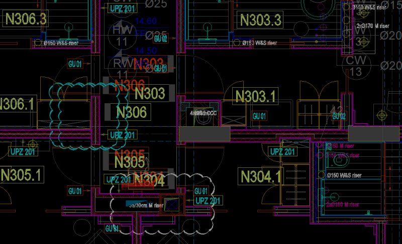

Heres a couple of screen shots of the the drawing not being panned & one when panning..
