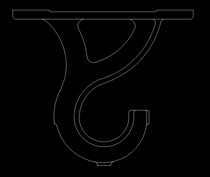

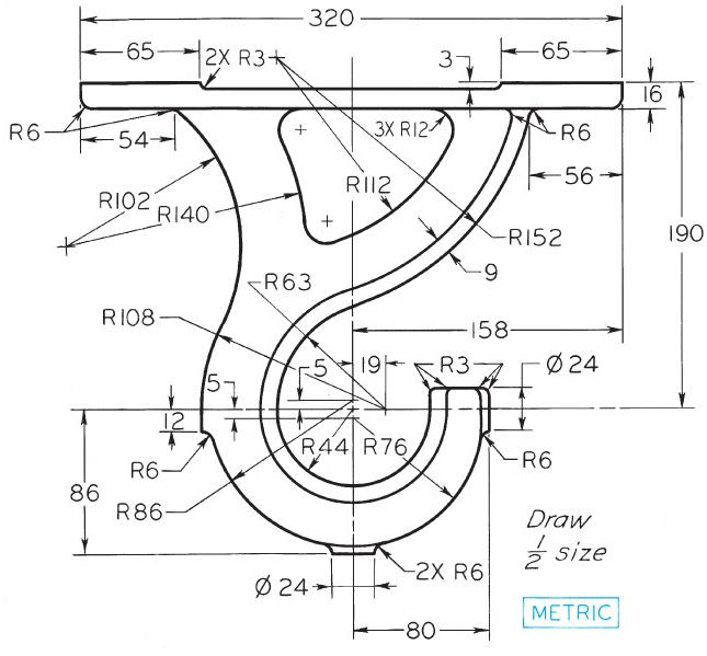

sean214 Posted November 5, 2012 Posted November 5, 2012 (edited) My instructor sucks I dont even know how to begin this drawing. I need to draw it in ISO...I already have the template ready I just cant get it started. Please help me get started dwg file Edited November 5, 2012 by sean214 dwg file Quote

Dadgad Posted November 5, 2012 Posted November 5, 2012 Welcome to the forum. I am guessing that you mean in metric (ISO) units rather than in an Isometric view. Draw it FULL SIZE. You can scale it later through a viewport. Or if for some reason you had to, you could just create a copy of it, and scale it by 50%. In cad we always draw everything at FULL SCALE. EVERYTHING. Yes, you heard right, EVERYTHING. Scaling is achieved through VIEWPORT scaling. Quote

MSasu Posted November 5, 2012 Posted November 5, 2012 You should start from the base of the hook (that it, the above part in your sketch). Draw for beginning a 320 x 16 rectangle and use it as a base for the rest of sketch. The paper asks for a half size drawing; the best solution to achieve that is to draw it full size (1:1) and then load it on sheet using the Paper Space feature. If you don't know what is that, then still draw it 1:1 and later scale it down with 0.5 factor. I admit that the sketch is a little difficult for a beginner, but judging his complexity I would guess that you have already some advance into the AutoCAD course for your instructor to ask for such assignment. (Edit: Oops, the scale procedure was already described by Dagdad!) Quote
ReMark Posted November 5, 2012 Posted November 5, 2012 I could do it but I'm not sure I could explain it easily. Where the Fillet command doesn't work try using the Circle command with the TTR option. Pay close attention to where the center points of the various arcs are located. It makes a big difference. I had to sort of back into a couple of them since they are not directly called out dimension-wise. Quote
JD Mather Posted November 5, 2012 Posted November 5, 2012 i meant iso metric ...now what do you really mean? The units are metric - as stated on the drawing. Isometric is a 2d representation of 3d. You would use isometric grid, F5, isocircles and all that.... Might be easier to just model in 3D. What does your instructor really want? What chapter is this in the book? (looks like Giesecke - Technical Drawing) I dont even know how to begin this drawing I would expect that a student should be able to draw this without instruction by the time this is encountered in the book. (foundation to get here would have been covered weeks ago) I'm still not sure what you want (isometric or simply AutoCAD iso template metric) Get what you can on your own and then attach your dwg file here so that others can see where you need help. Quote

ReMark Posted November 5, 2012 Posted November 5, 2012 As I said earlier, it can be done you just have to pay attention to where certain center points of arcs are located. Two of the arcs, with radii of 102 and 152, may be problematic for those not familiar with drafting techniques. If you don't want to use the Arc command you could always resort to using the Circle command and trim away the portions you don't need. Some of the commands I used were line, arc, circle, trim, fillet and offset. Quote
sean214 Posted November 5, 2012 Author Posted November 5, 2012 yes, thanks...im having that problem now...i ill upload the dwg...a tutor is suppose to help me today so lets see how that goes... [ATTACH=CONFIG]38362[/ATTACH]I could do it but I'm not sure I could explain it easily. Where the Fillet command doesn't work try using the Circle command with the TTR option. Pay close attention to where the center points of the various arcs are located. It makes a big difference. I had to sort of back into a couple of them since they are not directly called out dimension-wise. Quote

rkent Posted November 5, 2012 Posted November 5, 2012 You start by drawing the center lines. From there you offset to define the top of the hook. From there you find lines you can either offset or draw from the dims given. Then draw circles from the center line to the radius shown, trim as needed. Keep going from there offsetting the resultant arcs, ..... Quote
JD Mather Posted November 5, 2012 Posted November 5, 2012 If you didn't already realize - ignore the note on the lower right corner of drawing to Draw 1/2 size. In AutoCAD you should always draw full size (and if for some reason you need to scale it later - that is trivially easy to do). Quote

sean214 Posted November 5, 2012 Author Posted November 5, 2012 THANKS EVERYONE. I'm done...Someone helped me and I think I got it....off to dimmention it Quote
