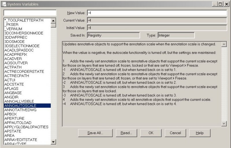

By using the SYSVDLG command you can learn mind boggling amounts of stuff about
the available system variables in the software, as shown in the image.
It is also a very good idea to occasionally do a SAVE ALL, which will give you a .SVF (system variable file),
ensuring that should something get changed inadvertently, rocking your system variable boat, you will be able to
restore your equilibrium and an even keel, as simply as using the READ button at the bottom of the SYSVDLG box.
For those who have not saved a .SVF file, this is also the easiest way to restore the default system variable values.

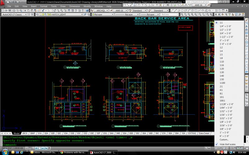

OK, then. Now I understand. What rkent said, do that. It would help though if you were to be able to pick the scale you intend to use in your layout viewport at this point, but you can always add it later.
I thought you were looking at the same scale list I get when I click the Annotation scale button on my tray, like this...

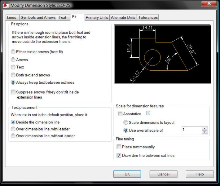

I still have some measurements that appears on an extended line instead of between the dimlines. (Basically I want 200 to be placed in the middle of the dimlines like 700 is.) Is there a way to achieve this?
http://i50.tinypic.com/n1yx3a.png
Thank you, guys.

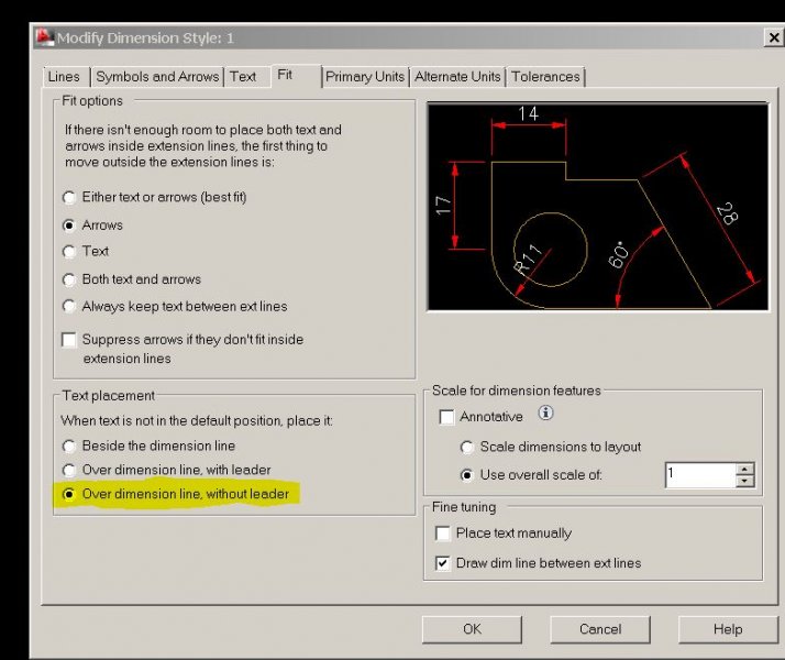

In your dimstyle editor you can tell it to force the dimension in between the extension lines, but there is a limit to what it can do. If there simply is not enough room, it ain't goin' in there. Your lines are closer together than your text is wide, by a long shot. You're right, it doesn't look very neat, but it is (mostly) industry standard. I used to do it when I drew on paper too, back in the day.
I detest the look of a dimension out on a leader too. Try putting it above the lines without a leader.
It'd look even worse if you were to shrink the text to fit by editing that one dimension.
You can also adjust the width of your font in the test style editor but there is a point in there where it becomes hard to read. Below a width factor of 0.75 or so it gets ugly.
If there simply is not enough room, it ain't goin' in there. (where have you heard that before?)

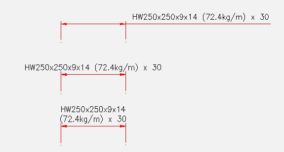

I'll drink to that, I always try to use 'Over dimension line, without leader',
should the text not fit on the dimension line, often putting a return in
the measurement if need be, due to space constraints, like in the image.

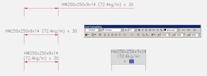

Hey, do me a quick favor and show me how to put a return in a dimension. I have on occasion wanted to use it, but never figured it out. It's just one of them things that I can't seem to find while it is right in front of my face.
Unlike that Sammy's Boston Lager, eh?
Just select the dimension, then double click on the text to go into the edit mode, and hit return,
just like you are editing MTEXT. :beer:
You're kidding. That simple? Well, all I get is the properties sheet. Funny, I can double-click edit ANYTHING else in a drawing except dim text. And DIMTEDIT only lets me move the text around. Am I being LT'd again?
Then you can probably do it like in the image, in the TEXT OVERRIDE box. :beer:
Do you get the TEXT FORMATTING tool, like in my earlier post, if you edit MTEXT?
