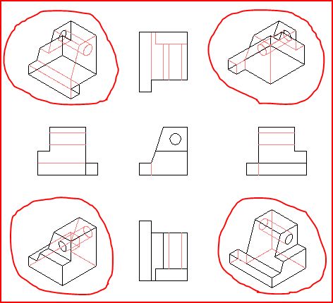

dantheman Posted October 31, 2012 Posted October 31, 2012 Hi, I am trying to draw an isometric version of this part from first angle orthographic projections. But for the life of me I can't, I have never been good at nets/projections etc. Can anyone help? Quote

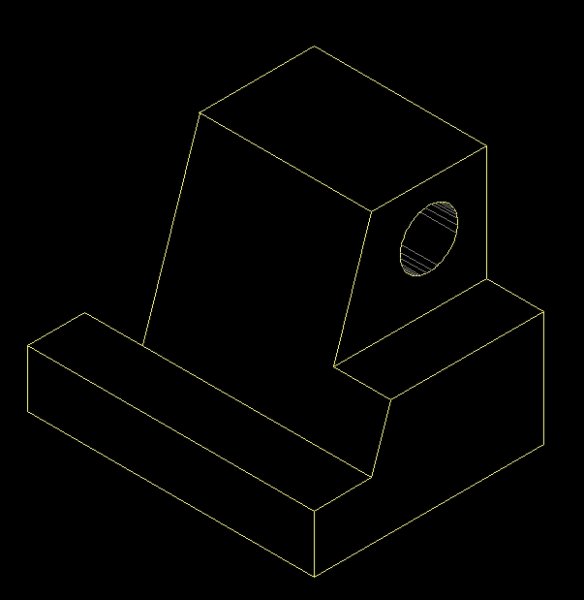

nod684 Posted November 1, 2012 Posted November 1, 2012 Anyone? Any help? I just need to know the shape the isometric projection should be so I can create it in autocad. it will look something like this Quote

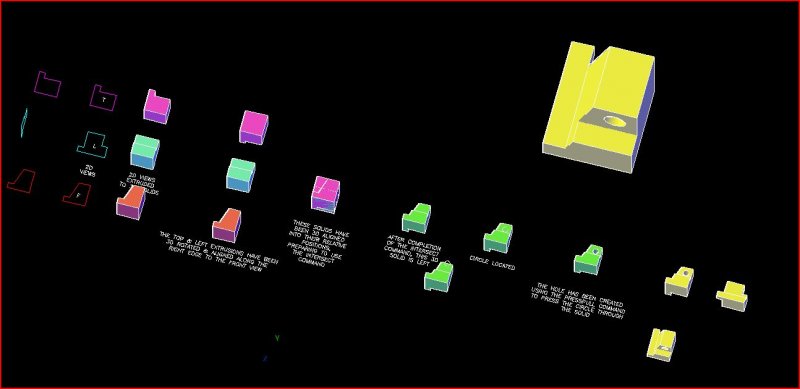

Dadgad Posted November 1, 2012 Posted November 1, 2012 (edited) I would much rather MODEL this, than DRAW it, I guess nod would agree with that. Once it is modeled and you have chosen an isometric perspective, there are lots of different ways to draw it. You are using 2012, so you have the VIEWBASE functionality, which is the easiest of them all. Edited November 2, 2012 by Dadgad Quote
Dadgad Posted November 1, 2012 Posted November 1, 2012 (edited) The attached images took all of about 2 minutes to generate including changing the layers and color displays of the hidden lines which are shown in pink, by using the VIEWBASE command. Edited November 1, 2012 by Dadgad Quote

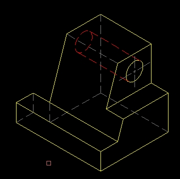

nod684 Posted November 1, 2012 Posted November 1, 2012 @Dadgad nice detailed presentation but i think you got the top view wrong as per his attached image. the "bar" at the front / bottom does not extend to the rear side. it stops at the sloped portion...that's why he has the 30.5 vertical hidden line see my isometric Quote
Dadgad Posted November 1, 2012 Posted November 1, 2012 (edited) Thanks for being so diplomatic nod, right you are. Using first projection really screws with my head, I always use 3rd projection. I will go back and correct my model, thanks for bringing it to my attention. Edited November 1, 2012 by Dadgad Quote
