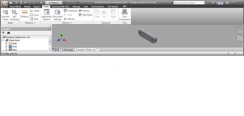

vkmaynard Posted November 1, 2012 Author Share Posted November 1, 2012 Thanks. Found it, installed it, does not show on the ribbon. Quote Link to comment Share on other sites More sharing options...
Bishop Posted November 1, 2012 Share Posted November 1, 2012 Part modeling environment, tools tab, right side. Quote Link to comment Share on other sites More sharing options...
vkmaynard Posted November 1, 2012 Author Share Posted November 1, 2012 Not there Quote Link to comment Share on other sites More sharing options...
vkmaynard Posted November 1, 2012 Author Share Posted November 1, 2012 Problem solved thanks to PhilippeLeefsma Senior Developer Consultant. He sent a link to the correct version for 2011. Note: This tool converts a Thread Festure not a Hole Feature using a thread. Thanks Philippe!! Quote Link to comment Share on other sites More sharing options...
