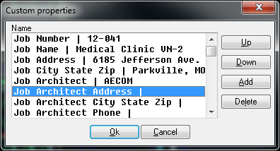

Guest kruuger
  Keywordkid said:
This looks interesting, is it just the dcl file that I need to edit for my preferred fields?
what do mean by fields ?
you can change width of DCL to make it wider.
more props looks like this:
kruuger

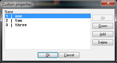

we can add also dwgprops to folder with files via ObjectDBX
(defun c:PRO (/ _AddCustom)
 (defun _AddCustom ( doc )
   (vla-AddCustomInfo (vla-get-SummaryInfo doc) "One" "1")
 (LM:ODBX '_AddCustom nil T)
need Lee wraper: http://lee-mac.com/odbxbase.html
kruuger

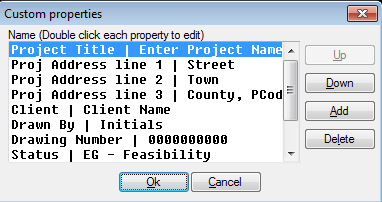

For clarity to my users I have edited the label to include some instruction so they don't make my mistake:
I just edited the CUP.dcl
//            MAIN_DIALOG            //
CUP : dialog {
 label = "Custom properties";
 width = 62;
 height = 5;
 : row {
   : list_box {
     key = "PROP";
     label = "Name (Double click each property to edit)";
     width = 35;
     multiple_select = true;
     fixed_width_font = true;
   BUTTON_EDIT;
 BUTTON_OK_CANCEL;
Thanks Kruuger :)
Guest kruuger
good point Keywordkid.
to get more space you can delete fixed_width_fint line (standard font)
kruuger
