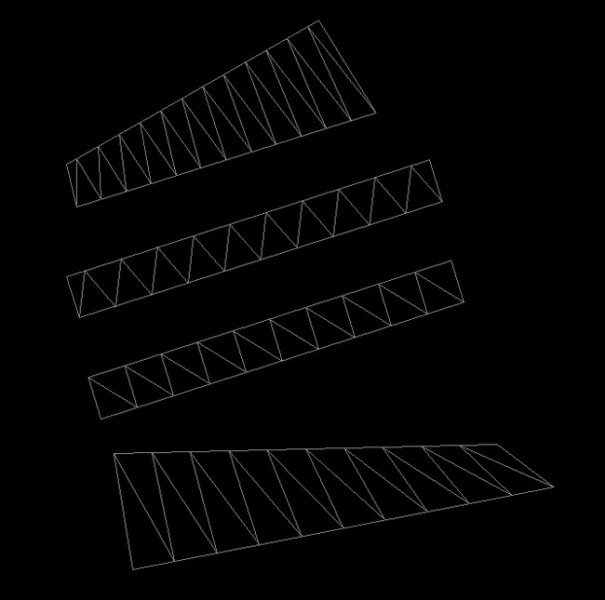

The routine is still pretty basic, but this new version, I solved the problem of UCS with another solution. Basically, an option intended to draw both basis orthogonal mode as parallel lines in rows and not in parallel with angle. Apparently is solved.
;;by teknomatika 10/2012
;;draw truss lines - variant perpendicular
(defun c:ZIGP (/ nd p1 p2 p3 p4 div1 ang1 div2 ang2 pt1)
(setq oldclay (getvar "clayer"))
(command "layer" "new" "truss" "color" "8" "truss" "")
(command "layer" "set" "truss" "")
(setq nd (getint "\n Nº divisions:"))
(setq p1 (getpoint "\n Specify start point of base line :"))
(setq p2 (getpoint p1 "\n Specify end point of base line :"))
(setq p3 (getpoint "\n Specify start point of top line :"))
(setq p4 (getpoint "\n Specify end point of top line :"))
(setq div1 (/(distance p1 p2)nd))
(setq div2 (/(distance p3 p4)nd))
(setq ang1 (angle p1 p2))
(setq ang2 (angle p3 p4))
(setq pt1 (polar p1 ang1 div1))
(command "_.line" "_non" p1 "_non" p3 "")
(command "_.line" "_non" p3 "_non" pt1 "")
(repeat (- nd 1)
(setq p1 pt1)
(setq p3 (polar p3 ang2 div2))
);repeat
(command "_.line" "_non" p2 "_non" p4 "")
(setvar "clayer" oldclay)
);defun
(prompt "\n Type ZIGP ")
;;draw truss lines - variant zig-zag
(defun c:ZIGZ (/ nd p1 p2 p3 p4 div1 ang1 div2 ang2 pt1)
(command "_.line" "_non" p3 "_non" p1 "")
(setq p3 (polar p3 ang2 (/ div2 2)))
(repeat (- nd 1)
(setq p1 pt1)
);repeat
);defun
(prompt "\n Type ZIGZ ")
