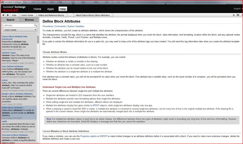

Dadgad Posted October 24, 2012 Posted October 24, 2012 (edited) The attached image should help you. The TAG is not what is written in the attribute, it is more like a placeholder, and it cannot contain spaces, among other symbols. The DEFAULT is what is actually in use in the ATTRIBUTE. You should not be in the BLOCK EDITOR, but rather the ENHANCED ATTRIBUTE EDITOR, when changing ATTRIBUTE values within a particular drawing. Edited October 24, 2012 by Dadgad Quote
Dadgad Posted October 24, 2012 Posted October 24, 2012 I suggest you use your F1 key and access the Autocad help files, from which I accessed the following by searching for ATTRIBUTES Quote
