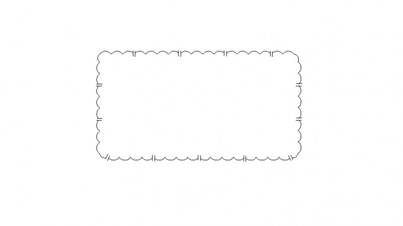

Hi there..
can anyone please assist me on how to create a new linetype like this one.
at first i have to make normal cloud then trim the cloud between "||" and it takes ages to complete. :?

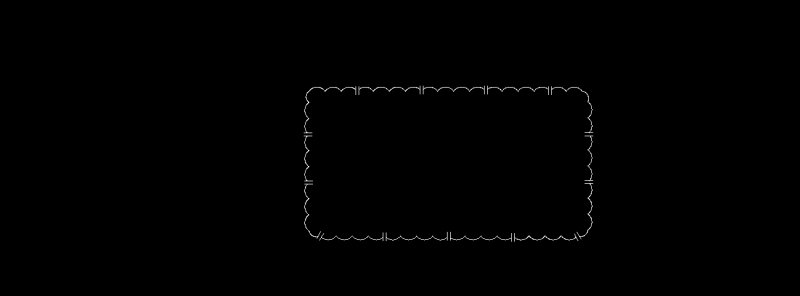

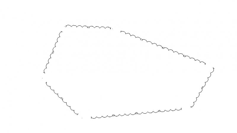

I did try to make the .lin file but it turned out like this :facepalm:
"*CLOUD,cloud
A,0,-183.205081,[DWG,C:\Users\admin\Desktop\Drawing1,s=1],-183.205081"
*close enough i think*
appreciate if you guys can assist me with this issue.
Thanks..

thanks Tiger!!thanks for the comment.. i have upload the image below..

Just out of curiosity, what is the significance of the two vertical lines?
We have to update our P&ID/equipment layout drawings. We usually use normal cloud to mark the scope of our project. But now we have 2 projects. Project A use normal cloud and project B use cloud with 2 vertical lines. We want to differentiate between those 2 projects.

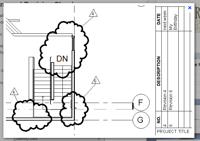

I thought that is why the Revision block was created and the triangle with the number inside used to denote the areas of the drawing the revision applied to. You've heard of this method right?
What happens if there is a third revision? First revision = normal cloud. Second revision = cloud with "||". Third revision = ??

You may start from this definition:
*MABO86_CLOUDLINE,Mobo86 cloud linetype _____||_____||_____||_____
A,.7,-.05,["||",STANDARD,S=.1,R=0.0,X=-0.06,Y=-.01],.1

No, the cloud itself is not created with a triangle. A triangle, with a number inside of it, is placed next to the cloud the revision references. The same triangle and number is shown as the item number in the revision block of the drawing. This is pretty much a standard across many disciplines and I am surprised you are not aware of it.
Your company does utilize a revision block does it not?
What happens when there is a third revision?
An example of a revision cloud with reference number triangle.
