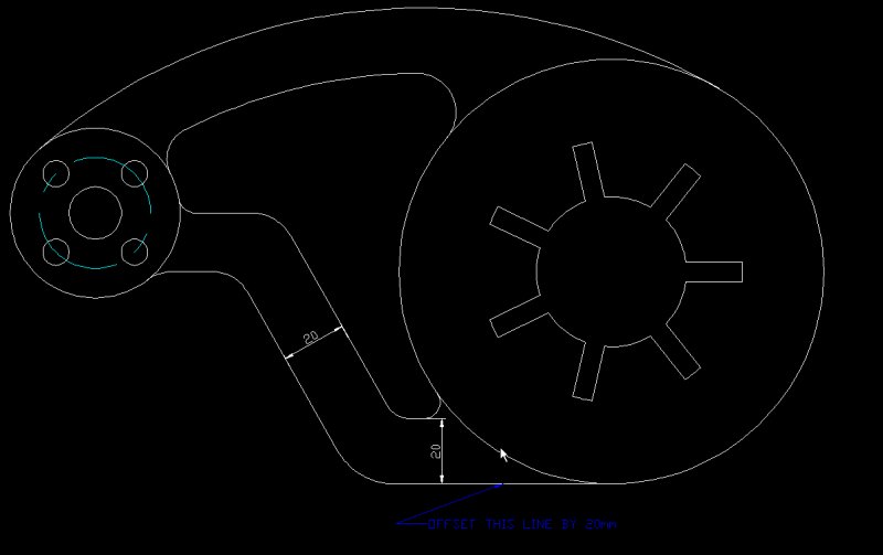

I need to draw this drawing. This is how much i did. Anybody could help me to finish it?
Why? It looks like you've not the bulk of it. All that is left is the bottom section then you need to add some centre lines and the dimensions which is the easy part.
The problem is that i can not figure out how to finish that bottom section. In my point of view data are not enough.
Offset is 20mm for all, so assume (remember: Assumption is mather of all f... ..) it is 20mm for missing dimension
mdbdesign, could tell me how did you find out that offset should be 20?
The measurement of '37' at the bottom represents the point where the 2 edges would meet if they were not filleted. Drawing a line from this point to the centre of the fillet arcs will give you your centre lines (perhaps offsetting your current lines by 20 will also achieve the same result?).
The 'R5' arc can then be drawn the same way you did the 'R12' at the top section.
Hope this helps and good luck!

SAFeSTeR and mdbdesign, thank you both! I tried both solutions and the result is the same.
