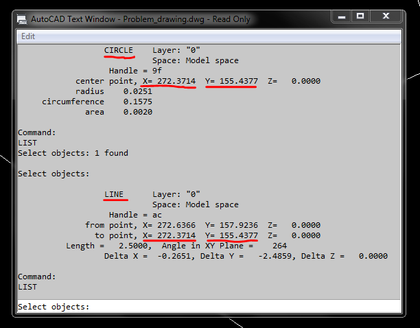

SLW210 Posted October 22, 2012 Posted October 22, 2012 Try setting FACETRES=10 You neglected to mention you were snapping to 3D Cylinder. Quote
ReMark Posted October 22, 2012 Posted October 22, 2012 There is a way to verify that it is right simply by drawing a line from the center of the larger circle to the smaller circle. Do a list on both the line and the smaller circle. Look at the X/Y coordinates of both. What we should see is that the center of the circle and the endpoint of our line share the exact same coordinates. Which they do: So, I agree with RobDraw. The error is in the eye of the beholder and does not indicate that AutoCAD itself is the source of the problem. Quote
MSasu Posted October 22, 2012 Posted October 22, 2012 aglaerum said: The inaccuracy is measurable, it is 0,04mm,more with bigger circle, but this is measured whitout Nearest snap on, as it will just snapp to the same point. The OP was talking about a measured difference - it will be intersting if he/she will mention how was validated that. Quote
ReMark Posted October 22, 2012 Posted October 22, 2012 With the method I just outlined the "measured difference" would be zero. Darn those quotation marks they just keep slipping in there. Quote

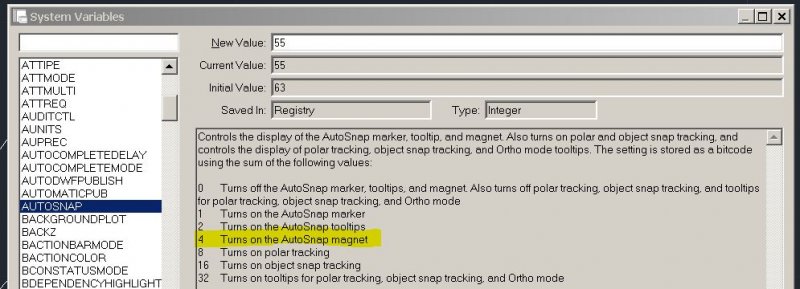

rkent Posted October 22, 2012 Posted October 22, 2012 Set APBOX to 1, APERTURE to 7, try again. Quote
