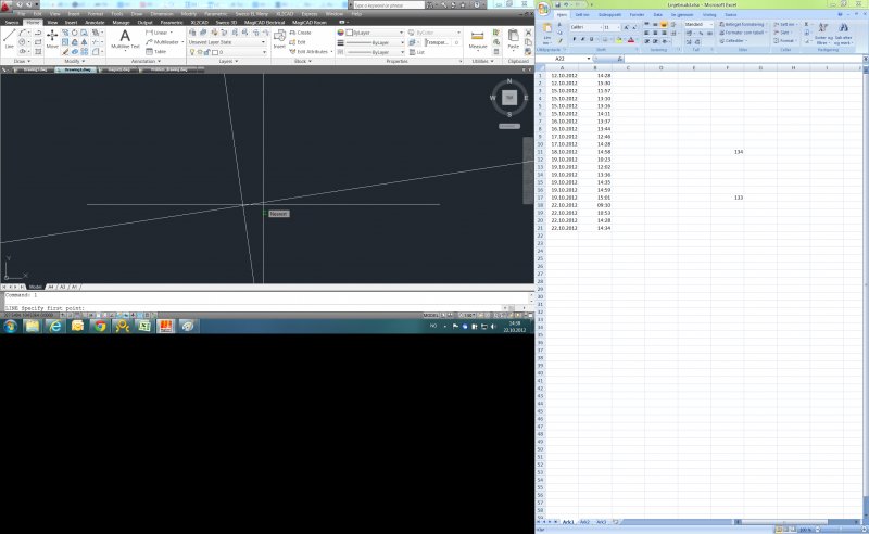

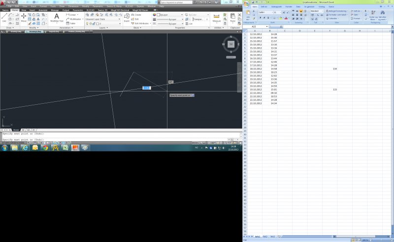

aglaerum Posted October 22, 2012 Author Posted October 22, 2012 RobDraw said: So what exactly is the CAD problem? Did you find something else? We already proved that the center of the circle ends up on the other circle as desired. I am sure it behaves correctly with you, I replyed to fast when i confirmed it. Still, my problem is simple! I snap to a circle and it seems to hit the circumference, I zoom in and it is far off, i do a regen, and it gets better, but not even close tho what it should be. When i try to snap in the new zoom level, the snapsymbol is so far away it is off the screen. You see? Quote

aglaerum Posted October 22, 2012 Author Posted October 22, 2012 RobDraw said: I am trying to save you some embrassment here. If the center of the circle does lie on the other circle, we proved that, then there isn't a CAD problem. It is a graphics problem. I will now save some pictures for you, you wont be able to say there is no problem, 2 sec. Quote

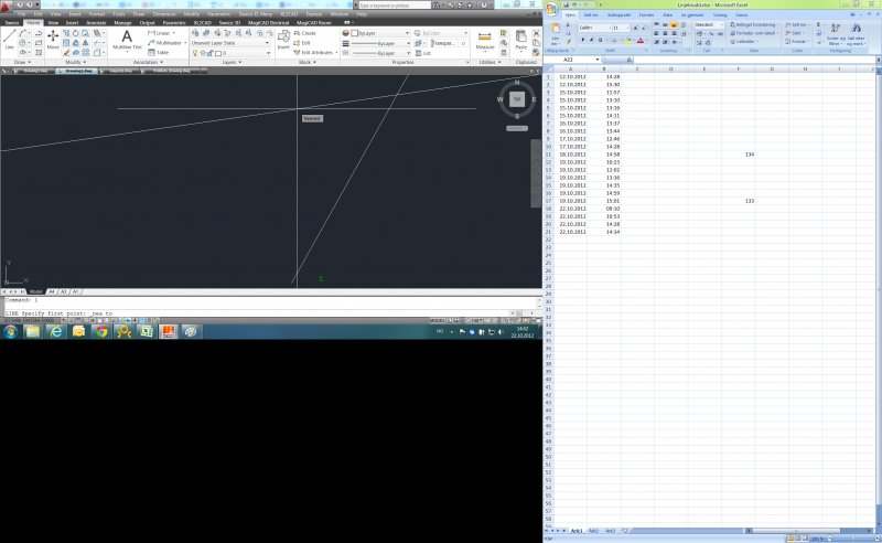

aglaerum Posted October 22, 2012 Author Posted October 22, 2012 RobDraw said: I am trying to save you some embrassment here. If the center of the circle does lie on the other circle, we proved that, then there isn't a CAD problem. It is a graphics problem. I want to be able to snap to the point where this line meets te Circumference, i does not find a point to snap to, as i zoom in you see its no wonder since the line is not at the Circumference at all. There realy in no room for saying this is not a problem... Quote
aglaerum Posted October 22, 2012 Author Posted October 22, 2012 Damn, forgot to crop them, however you clearly see the line does not start at the Circumference, and in the top picture you see the snap symbol is almost off the screen, and YES i did REGEN. Still not a problem? Quote
