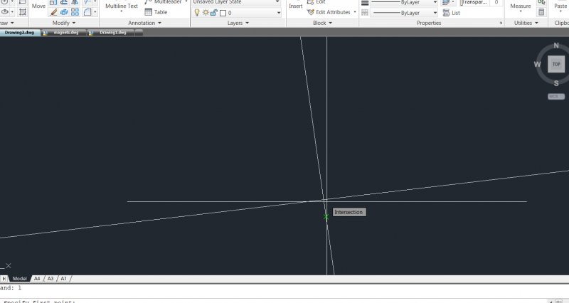

I tried to make a line from the center like you said, this is what happens, so its not just the nearest snap then!

I forgot to quote, but my new uploaded image is for you, and as you see it gives the same symptoms.
Can you post this trouble-maker drawing here for further investigation?
