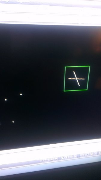

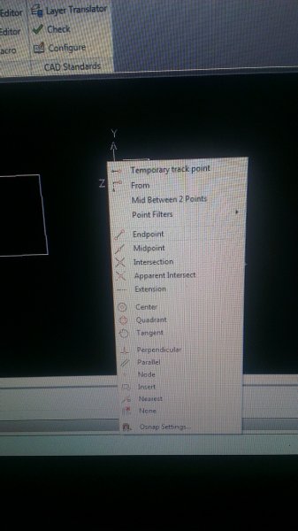

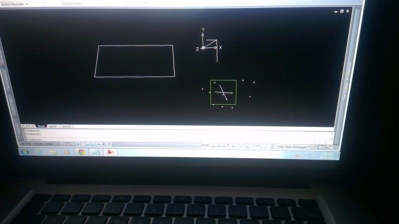

Maazy Posted October 20, 2012 Posted October 20, 2012 i have been using autocad since 2 years now. i installed 3dmax and also autocad 2013 recently. I think somehow the settings have been defaulted to some other setting. i cant really explain the issue but i am sure the pictures can. When i press the mouse wheel button, instead of it letting me pan around it opens up a SNAP option drop menu. My cursor is a SQUARE shaped with a command cross inside it, which does not allow me to hold on to the left click and select objects by making boxes. it just gives a plus sign where ever i click. here are a few pictures hope it makes sense. i want it to be the normal way like it is for everyone in the youtube video tutorials etc. so that i can start work. help is much appreciated. Quote
MSasu Posted October 20, 2012 Posted October 20, 2012 When i press the mouse wheel button, instead of it letting me pan around it opens up a SNAP option drop menu. This should be fixed by setting the MBUTTONPAN system variable to 1. My cursor is a SQUARE shaped with a command cross inside it You can set the size of said cursor in Options --> Display --> Crosshair size, respectively Options --> Selections --> Pickbox size. Alternatively, adjust the CURSORSIZE and PICKBOX system variables. And for sure, welcome to the Forum! Quote

Maazy Posted October 21, 2012 Author Posted October 21, 2012 hey, ya the advices work but its like i need to do them everytime again i open autocad. and i was not using any other version of autocad before this on this computer. so i dont think it can migrate any settings. i still cant get the grid and cursor to be normal, its still in a tilted cross and not the straight cross. i stil cant hold left click and select objects while dragging the box. Quote
ReMark Posted October 21, 2012 Posted October 21, 2012 Probably because your UCS is out of whack. Did you try UCS > World > Plan? Quote
eldon Posted October 21, 2012 Posted October 21, 2012 PICKDRAG should be 1. And the plus signs wherever you click could be that Blipmode is turned on. Quote

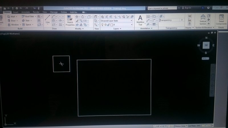

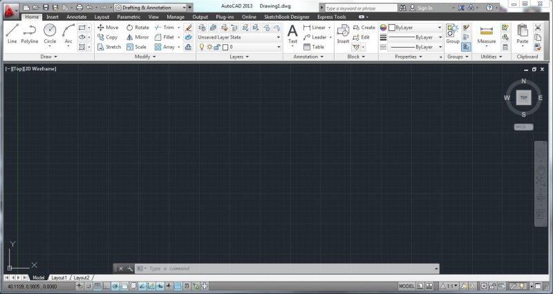

Maazy Posted October 30, 2012 Author Posted October 30, 2012 First of all thankyou for all your help, it did work for sometime for me. but then the main problem is that my settings did change and i have been going crazy on how to restore it to the normal one. i have reinstalled and uninstalled ten times now, different versions aswell, deleting all old files also of autodesk, and completely removing autodesk folder too. now the thing is the commands you all listed for me like mbuttonpan pickfirst pickdrag blipmode etc. they do work, but they are the only commands i could explain you all to which you all helped me. there are a few more settings changed which i cant explain whats happening and whats not. i will show you a picture of how i want it to be and how it isnt. the one with the grids and blue background is the normal settings which is in every other computer i have seen. but for me after reinstalling the program and opening it the first time it opens upto this black background with weird cursor which is in sign of a diagonal cross, and not a straight one even after uninstalling and deleting all document files of autodesk. and i cant hold on the click button and select the things in the green/blue box that i want. If anyone could link me up with an article or anything which would temme what settings i need to change overrall, that would be really great. here are the pictures. Quote
rkent Posted October 30, 2012 Posted October 30, 2012 Not sure why it doesn't reset when you reinstall, but I would try the following. SNAPANG = 0 SNAPSTYL = 0 PICKBOX = 7 (pick a number that works for you, 7 is a good place to start) CURSORSIZE = 10 (pick any number from 2 to 100) Quote
