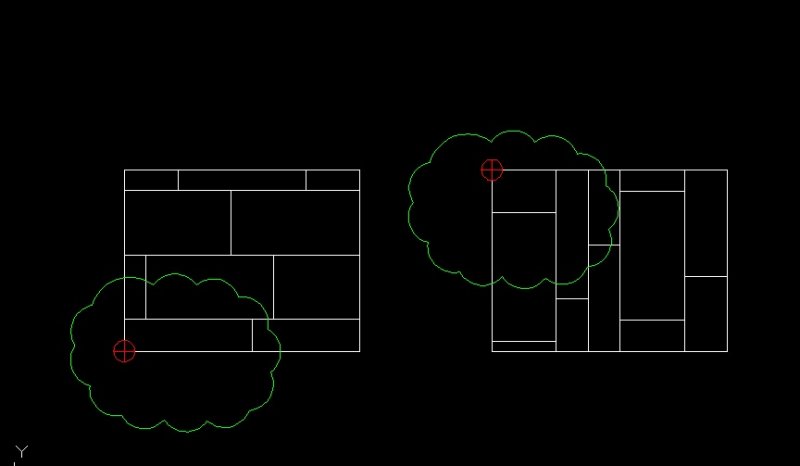

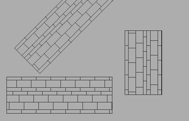

Elisabeth83 Posted October 18, 2012 Posted October 18, 2012 Hi, I have a simple brick like hatch that is set to have a full tile at the origin of the hatch. All is well when the hatch is horizontal:)but when the hatch is rotated within the hatch edit box it loses the origin and it won't set with a full tile:cry:. Can someone help please!!! How can I get the origin to be the same at any angle and the hatch start with a full tile???????? Quote
ReMark Posted October 18, 2012 Posted October 18, 2012 Isn't there an option in the Hatch dialog box to "Specify origin"? Quote
Elisabeth83 Posted October 18, 2012 Author Posted October 18, 2012 Yes there is but when an origin is chosen for the hatch at an angle (or anything other than horizontal) it does not start with a full tile?? The hatch is meant to start with the thin tile first (as in the horizontal hatch) but it doesn't as soon as its angle is changed (as in the vertical example) Quote

Elisabeth83 Posted October 18, 2012 Author Posted October 18, 2012 The hatch has been written and then inserted into the support files (with the help of the friendly cadtutor forums!!). I had to adjust the code as we were required to specifically set out the tiles according to the manufacturers details which is why its important that the hatch starts with the correct full tile!! up untill now if we have to use the hatch at an angle we are rotating the area so its horizontal then hatching it and the rotating back into the correct position!! its a real pain and very time consuming!!!!! Quote

Elisabeth83 Posted October 18, 2012 Author Posted October 18, 2012 Hatch pattern below! *FLOOR TILES, tiles 0, 0,0, 0,1350 0, 0,150, 0,1350 0, 0,450, 0,1350 0, 0,750, 0,1350 0, 0,900, 0,1350 0, 0,1050, 0,1350 90, 0,0, 0,600, 150,-1200 90, 100,150, 0,600, 300,-1050 90, 500,450, 0,600, 300,-1050 90, 850,750, 0,600, 150,-1200 90, 1800,900, 0,600, 150,-1200 90, 2200,1050, 0,600, 300,-1050 * Quote

eldon Posted October 18, 2012 Posted October 18, 2012 I think that you do not need the last * in the file. But I had no trouble in making the hatches behave. Because my version of AutoCAD is older, there is no means of setting the hatch origin. So I always set up a UCS on the corner of the hatch, and the hatches come out as meant to. Quote
hugha Posted October 18, 2012 Posted October 18, 2012 For a hatch rotated through 90 degrees, pick the hatch origin to be at the bottom right of the area. For a hatch origin at the top left, rotate by 270 degrees. Other outcomes can be obtained by using this mirrored pattern: *FLOOR TILES MIRRORED,tiles ;------------------------------------------------------------------------------- ; Pattern written by HatchKit v2.7 Hatch Pattern Editor ; HatchKit v2.7 Hatch Pattern Editor© Cadro Pty Ltd 1990-2012. ; www.hatchkit.com.au ;------------------------------------------------------------------------------- ;-Template=FLOOR TILES, tiles ;-Source =C:\Documents and Settings\Hugh\Desktop\FT.PAT ;-Date =19/10/2012 ;-Time =9:27:19 AM ;-HatchKitVersion=2.7.1.1995 ;------------------------------------------------------------------------------- 180,0,1050,0,1350 180,0,900,0,1350 180,0,750,0,1350 180,0,450,0,1350 180,0,150,0,1350 180,0,0,0,1350 90,-850,750,0,600,150,-1200 90,-1800,900,0,600,150,-1200 90,0,0,0,600,150,-1200 90,-100,150,0,600,300,-1050 90,-2200,1050,0,600,300,-1050 90,-500,450,0,600,300,-1050 hth, Hugh Adamson www.cadro.com.au Quote

Elisabeth83 Posted October 19, 2012 Author Posted October 19, 2012 Thanks for the above, I have had a go at the mirrored version but seems to affect the specific setout details that we have to follow:(. The UCS set does work with the origin for the hatch:D just a bit of a pain set up for every hatch!!!! Thankyou! Quote
