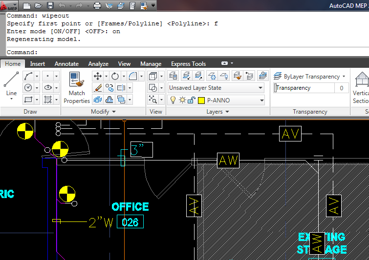

i am currently having a problem which (looks like) i have a background mask that will not delete even tho there isn't any text there. i cant select this or delete it.
that's a print screen of one of the areas that's effected

Could it have anything to do with the setting of the system variable FRAME?
Are you sure they are wipeouts and that someone hasn't just trimmed the lines?
Use the command IMGFRAME. That will toggle the visibility of the edges of the wipeouts. You can then delete the wipeouts.
Unknown command. The correct one, IMAGEFRAME, does not control wipeout frames.
I take it that all "frames" are not controlled by one command? I don't use wipeouts and seldom (counts on one hand) use image frame thus the reason for my question.
Thanks for the quick responses. the wipeout command suggested by RobDraw worked perfectly

At one time I believe there was only one type of image, so there was only one command to toggle the frames. Now you can control frame visibility and plotting for images, PDFs, DGNs, DWFs, and who knows what else.
I've tried wipeouts. So far there's always been a better solution.
Sorry, RobDraw, didn't notice the wipeout in your post. I bow to the superior ninja.
