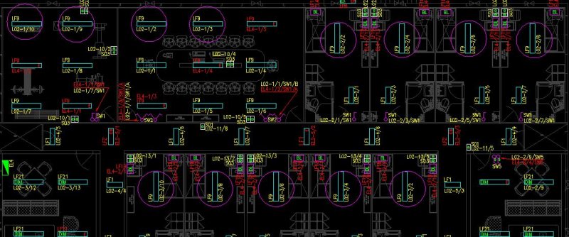

esputro Posted October 17, 2012 Posted October 17, 2012 Dear all, Sorry if this title was discussed before, please does anyone know lisp to find block and mark them. i have a lot block with my drawing and make some change with them, but it's to much time to find one by one. thanks you, esputro Quote

esputro Posted October 17, 2012 Author Posted October 17, 2012 Hi Pbe, sorry, please find attachment for illustarion. examples, I have drawing with huge off block, and i want to find (Ex.Block LF9) and after that mark of them automatically with lisp where there are. if i do manually i think it will spend the time.. Thanks, esputro Quote
pBe Posted October 17, 2012 Posted October 17, 2012 I understand what you mean esputro, but tell us what exactly are you're going to do with the block when found? Put a marked on the block and leave the mark there? Quote
esputro Posted October 17, 2012 Author Posted October 17, 2012 hi pbe, it's just for my reference, i am electrical and i have equipment tagging that i need to change. thanks, rgds Quote
pBe Posted October 17, 2012 Posted October 17, 2012 if thats all you want to do then use the snip i posted on my first post or (defun c:markb (/ bn blks e)(vl-load-com) (setq bn "Block LF9") (if (setq blks (ssget "_x" (list (cons 2 bn)(cons 410 (getvar 'ctab))))) (repeat (sslength blks) (vla-highlight (vlax-ename->vla-object (setq e (ssname blks 0))) :vlax-true) (ssdel e blks) ) ) ) or even QSELECT Quote
esputro Posted October 17, 2012 Author Posted October 17, 2012 thanks pbe that works, but the problem is if i choose for others block i must change again for lisp. do you have any idea for general options to show all existing blocks. Rgds, esp Quote

pBe Posted October 17, 2012 Posted October 17, 2012 ahh. i think i misunderstood the OP (defun c:markb (/ bn blks e hl) (vl-load-com) (setq ef (lambda (e) (vla-get-effectivename (vlax-ename->vla-object e)))) (prompt "\nSelect Block to highlight") (if (and (setq hl (ssadd) bl (ssget ":S:E" '((0 . "INSERT")))) (setq bn (ef (ssname bl 0))) (setq blks (ssget "_x" (list '(0 . "INSERT") (cons 2 (strcat bn ",`*u*"))(cons 410 (getvar 'ctab)))))) (progn (repeat (sslength blks) (if (eq bn (ef (setq e (ssname blks 0)))) (ssadd e hl)) (ssdel e blks) ) (sssetfirst nil hl) ) ) ) but then again. if the OP is planning to change a value on the block ...equipment tagging that i need to change.... , change the sssetfirst line to whatever function. Quote
