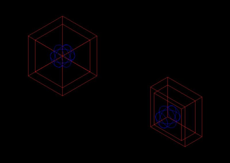

ReMark Posted October 16, 2012 Posted October 16, 2012 Cube with sphere. Cube is a solid. The one on the right has been sliced open. 2Dwireframe is the visual style. Quote

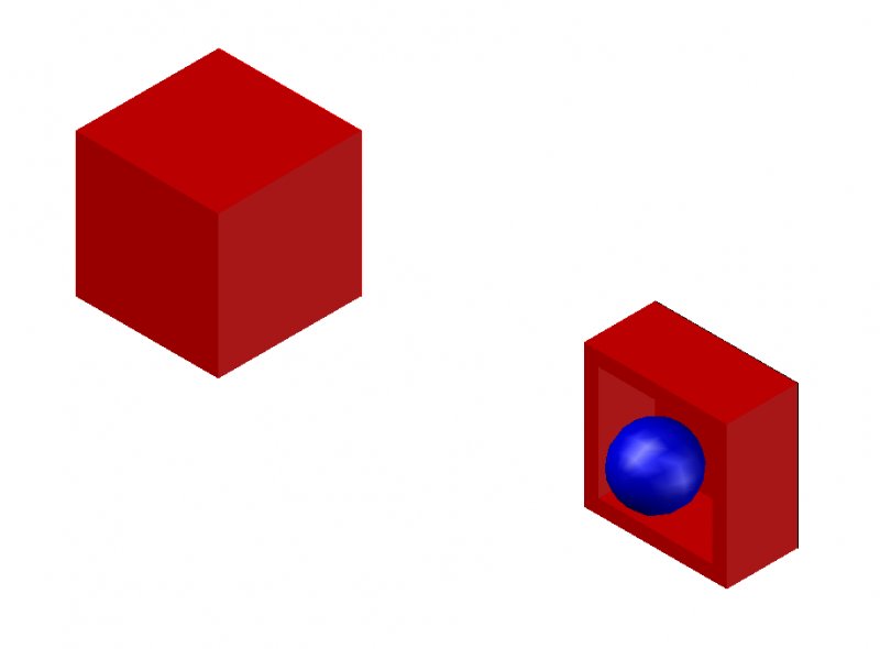

ReMark Posted October 16, 2012 Posted October 16, 2012 Cube with sphere in Realistic visual style. Quote

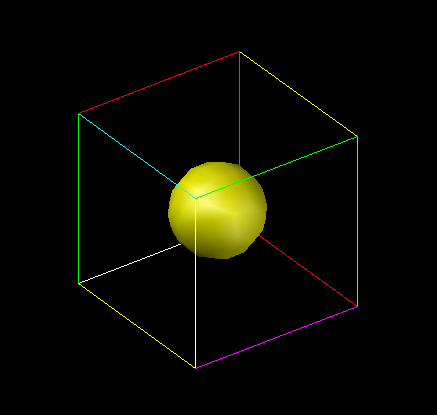

ReMark Posted October 16, 2012 Posted October 16, 2012 Sphere within a cube comprised of 12 individual polylines. Count them...I color coded them for you. Quote

turboCAD Posted October 16, 2012 Author Posted October 16, 2012 [ATTACH=CONFIG]37890[/ATTACH]Sphere within a cube comprised of 12 individual polylines. Count them...I color coded them for you. do the 12 lines move as one? if I click one, do all 12 light up? if so,how did you do it? it is exactly what I was looking for Quote
ReMark Posted October 16, 2012 Posted October 16, 2012 Yes they move as one because I created a block. Quote

turboCAD Posted October 16, 2012 Author Posted October 16, 2012 Yes they move as one because I created a block. that is it! thank you , ReMark! in case anyone else is reading this while trying to solve the same inconvenience: -group the lines in a block,like ReMark suggested: - select the lines/parts you are interested in joining/uniting, properties, set: color,linetype,lineweight by block(default is `by layer`) - type "block " in the command line(http://www.we-r-here.com/cad/tutorials/level_2/2-2.htm) -give the block a name ( ) - press "pick point" I picked the center of the cube by also drawing its diagonal, then units: unitless, -press "select objects": select the lines , select "scale uniformly " now,you should have a block made of all the lines you have selected. Quote
