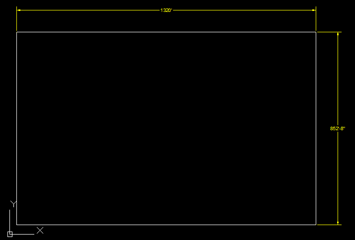

ReMark Posted October 17, 2012 Posted October 17, 2012 Another way to draw the perimeter of the building. Start with the normal LINE command, pick a point in the lower left-hand corner of your screen then (with Orthomode enabled - the F8 key) pull your mouse to the right and type 1352' (the mark is important) then pull the rubberband line up and type 852'8" then pull the line to the left and type 1352' and finally, leave your mouse alone, type the letter "C" at the command line (for CLOSE) and press Enter. Command: _line Specify first point: pick your first point Specify next point or [undo]: 1352' Specify next point or [undo]: 852'8" Specify next point or [Close/Undo]: 1352' Specify next point or [Close/Undo]: C The building perimeter will now consist of four individual lines. Do you know the difference between a line and a polyline? Quote
ReMark Posted October 17, 2012 Posted October 17, 2012 When you are finished it should look like this. I put dimensions on it so as to verify I used the ones you provided. Think about layers too. Don't make the classic newbie mistake and put everything on layer "0" in white or worse yet, override, the default color and start assigning colors to individual objects. You'll learn to regret it if you do. For a building you might want layers for the foundation, centerlines of steel, structural members, walls, doors, and windows for starters. Later on you'll add layers for text, dimensions, title block and border. Quote
Casio47 Posted October 17, 2012 Author Posted October 17, 2012 Super, thanks ReMark. I didn't quite get 1320", I got 1319'5" instead. Cant get my snap to work so I can snap directly on the line, but .5" away isn't bad. I increased my linear dimension text size to 80.0 and that seems to work ok. Also, I created a layer named "Factory Boundary", I already know about putting everything on the 0 layer...found out that mistake the hard way. Next up, the 60' x 40' grid. I'll suppose I'll create another layer for this as well. Thanks for the help. Quote
