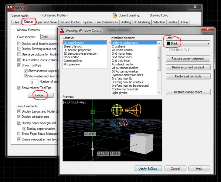

I suppose you tried changing the background color right?
Recognize this?
ReMark is right, it is probably not a visual style issue, and should be addressed in the DRAWING WINDOWS DISPLAY dialogue.
Notice that there can be different background colors for 2D, 3D, 3D Perspective, etc.
Additionally there is the Restore Classic Colors option. :)
