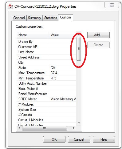

Hello im new here but there is something I cant do in auto cad that has been bothering me. I was wondering if anyone knows of a way to tab quickly through the custom properties fields having to click on each section to input data takes a lot longer than it needs to. Thanks
Double click on the slide bar and drag it down.
Thanks but thats not quite what I was talking about. There are a lot of feilds for me to enter info in. Is there a faster way than clicking on each box and using the scroll bar to select through them? Like when you use the tab key on an excel document.
If the key does not jump between the entries like it does in many other AutoCAD popups, your wishlist query does not exists.
