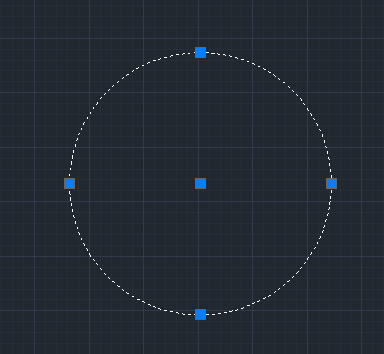

Thanks for getting back. I'm looking for the rectangular handles that surround the object, just like a MS Word handles.
Any suggestions?

If you are expecting Autocad to supply grips indicating the constraining box, as shown in your first image?
That will not happen with a circle displayed in Autocad. The only grips which are available for a circle (which is not a block entity)
are center and quadrants, as shown in the modelspace image.

You answered your own questions with your own screenshots: ALL AutoCAD grips appear at only the AutoCAD object snap pints of the AutoCAD object entity types selected.The is no bounding-box option.

Thanks for the responses. The advantage of having handles is that at anytime, I know the virtual center of an object(s), like a polygon or groups of objects. I know the center of a group when I want to move it as well. Acad does't indicate the center of a group of objects when selected. I have to choose a grip point on one object from the many in the same set, but with the virtual center of a group of objects, it makes it a lot easier, and I can easily change the reference grip easily.
