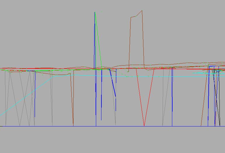

I see that the drawing has alignments and cross sections already drawn. As these are to the wrong level datum, I think it would be easier to input the data again, but with the levels corrected.
Can you post a few lines of the surveyed data, before it gets into AutoCAD? Just ten lines will do to see what sort of data it is.
To correct everything in the drawing will be quite a task. The 3D lines can just be moved vertically, but some of the lines are joining the 3D level point with a zero point, so if everything is just moved vertically, then it won't be as it should be. With the sections, they would have to be altered one by one, again a long job. As I said, it would be easier to change the input data.
The attached screen shot is a front view of your data

As you have found out, moving the whole drawing does not give you what you want. One problem is that there are lines which have an elevation (z value) at one end and the other end at zero elevation. So if you move everything -6.8m in the z direction, then all the points which were at zero are now at -6.8. Not a good thing.
However, if you make a front view, you are now seeing everything as a section, with the y axis being the elevation. So now you can stretch everything that is at an elevation downwards by 6.8. You need to have ORTHO on, then use the command STRETCH, and make the crossing box so that the bottom line of the box does not include the zero elevation line. Then move everything by 6.8 downwards. If ortho is on, you just need to pull everything downwards and enter in 6.8 on the keyboard (direct entry distance).
Now make a top view, and all the lines in your plan will be at the correct z value. Now change the current layer to cote, freeze all other layers. Start the lisp TextMath, and subtract 6.8 (or add -6.8 ) to all text. This will give all (2587) the correct elevation text vales. Thaw all layers, and plan is now correct.
