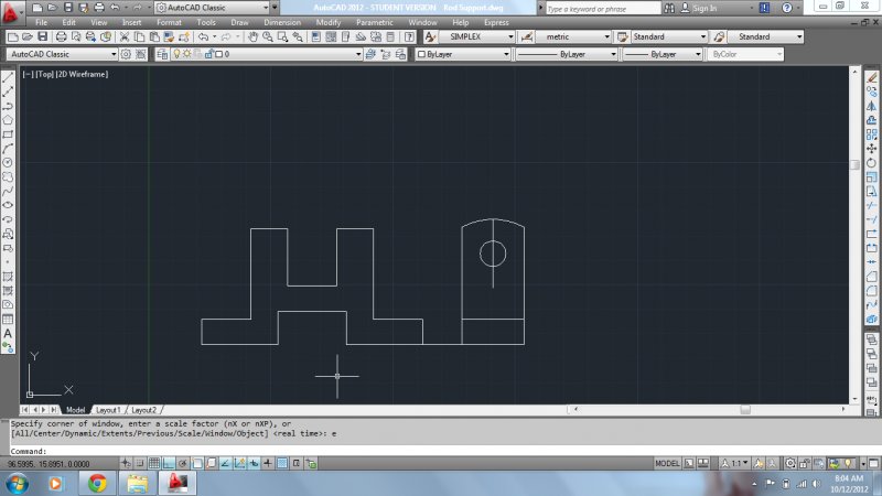

Here is the drawing I am working on now and below that is my progress!
I am not even sure of how to look at this drawing :S I drew two sides of it so far and don't know where else to start now

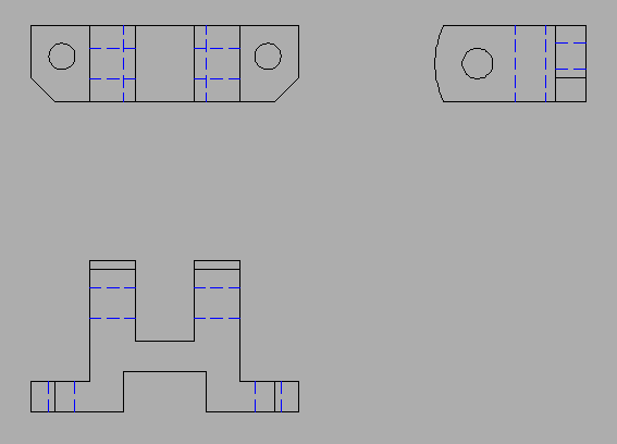

So you have an isometric drawing which you are attempting to create all the 2D views for or are you really attempting to create a 3D model?
The 2D views I think you are looking for.
Do you understand what is/isn't being shown in each view? Hint: hidden lines.

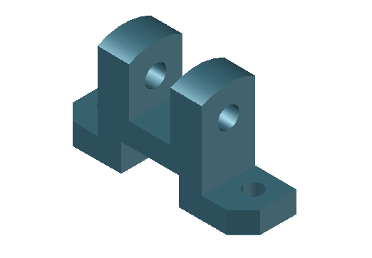

What the object would look like done as a 3D solid.
I am trying to create each 2d view. Yes and also I've been told to keep all the pieces the same short length apart so that when I plot it, it will look neat.That is why I have that 20mm line going from the H to the others side. . I will attempt to recreate the 2d views you showed and will get back to this topic, thank you!
