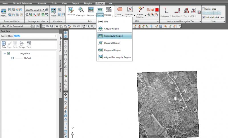

i received an orthorectified aerial image that is bounded by large white background, which i need to remove and still preserve the coordinate system attributes. i have plunked around with Raster Tools, but fear it is not as simple as a cut/crop tool and was unable to remove this white background.
any hints or leads on which tools to use in Raster Design?

Don't have the 2011 version of RD but in 2009 there is a crop tool. Then export the image to a new file and select to create the world file or geotiff.
Building on Murph's comments, you may find the ICROPPOLY (Crop Polygonal Region) Command, the IRUBPOLY (Remove Polygonal Region) Command, and/or the ITOUCHUP Command to be of particular use.
[ATTACH=CONFIG]37806[/ATTACH]
i tried in vain with all these tools, but nothing really worked, and was very time consuming. My problem was that i needed to preserve/cut out a very elaborate image "inside" a large, square white rectangle, so the only tool that kind of worked was the polygon tool and it was painstaking and not complete.
thanks though for the nice screen shots - they were helpful!
