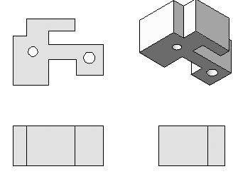

stenews Posted October 11, 2012 Posted October 11, 2012 Hi guys, does anyone of you to know why I can't set the hidden lines viewbase option to shaded with visible lines mode? Thanks, Stefano Quote
ReMark Posted October 11, 2012 Posted October 11, 2012 Is this the effect you were looking for? Is the option available in 2012? I used 2013. I don't have 2012 loaded on my home computer. Quote
stenews Posted October 12, 2012 Author Posted October 12, 2012 Hi ReMark, yes it is...do it using the attached file and see if you can to the same thing. I use 2013 too let me know what's the problem... copertina_vicino_duilio.dwg Quote
Dadgad Posted October 12, 2012 Posted October 12, 2012 Hi ReMark,yes it is...do it using the attached file and see if you can to the same thing. I use 2013 too let me know what's the problem... No problems that I can see. Unless you are unaware that each of these views can have different visual style settings. Left click on one you wish to change, then in the right click shortcut menu select EDIT VIEW. Then take a look at the image... Quote
stenews Posted October 12, 2012 Author Posted October 12, 2012 right...but the style does not change...it has no shade colour...it still remain in black and white Where I'm wrong may be I changed same setting... try to hit shaded with visible lines Quote
stenews Posted October 12, 2012 Author Posted October 12, 2012 Hi Dadgad... see what I mean...if I try to apply any colours I always see the view like black and white but If you try to copy and past the draw in a new template it works again...why Quote

ReMark Posted October 12, 2012 Posted October 12, 2012 No absence of shading here. Just tested it again this morning with a different 3D model. I wonder if his copy of 2012 has been updated with any service packs. Quote
Dadgad Posted October 12, 2012 Posted October 12, 2012 No absence of shading here. Just tested it again this morning with a different 3D model. I wonder if his copy of 2012 has been updated with any service packs. Hmmm, strange. When I tried it on his I couldn't get it to display shaded, but just created my own 3D Solid, and it worked just fine. Quote
ReMark Posted October 12, 2012 Posted October 12, 2012 I did not look at stenews' drawing. I guess I'll have to open it up now that you have. Quote
ReMark Posted October 12, 2012 Posted October 12, 2012 Same results here with his drawing. One odd thing I noticed. When I am in the layout and I look at the View panel the visual style is called out as "Xray" which is not the visual style back in model space. Yet, in my 3D drawing, when I look at the View panel while in my layout the visual style is exactly what it is for model space (i.e. - 2Dwireframe). That puzzles me. In your layout what does the visual style show up as and is it the same as model space? Quote
Dadgad Posted October 12, 2012 Posted October 12, 2012 I had XRAY in modelspace and without a VIEWPORT in the LAYOUT I don't believe there is a visual style in paperspace. I switched from Xray as soon as I saw it in modelspace, and switched to 2D Wireframe, and despite trying all manner of options have not been able to get it to shade. I tried creating a new 3D solid in his modelspace and it wouldn't display shaded either. I -Purged it and everything else I could think of. When setting up the viewbase views it is displayed as shaded, but as soon as I accept the layout with the right click, it all goes to unshaded. Quote
