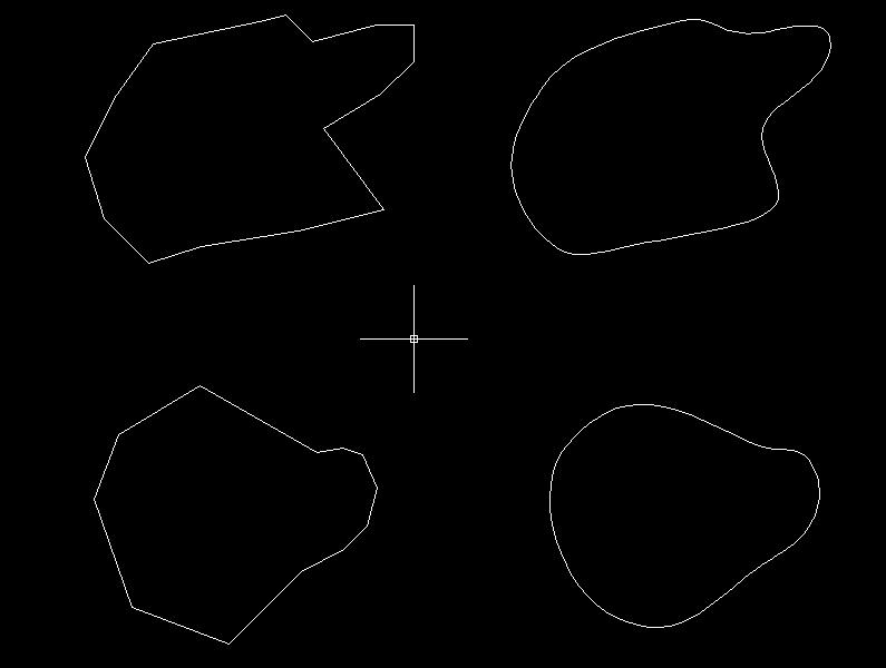

Probably for a landscaping plan (2D). I always just made some shapes with a closed polyline and then use the pedit command and then made it a spline.
