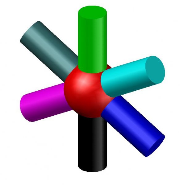

I want to be able to move the cylinder and take a point from the sphere where I can attach it(the cylinder).
I will use the sphere as a joint for multiple cylinders so the intersection between a sphere and any cylinder must always be the circle that forms the base of the cylinder NOT another circle parallel to the base(if the cylinder enters the sphere, if you place a metal rod through a snow ball, the resulting object is a bullet, a cylinder with a dome: not what I want).

I presume that the axis of those cylinders are intersecting the center of the sphere - is this is true, then just make the cylinders a little longer and use their base center point to move on sphere's center. After use copies of the sphere to get the cut on cylinders (SUBTRACT command).

Because I am building a lattice, I will have numerous cylinders and spheres so I need an elegant,repeatable solution to find the same point on the sphere.
MSasu: the centers of the two bases of the cylinder and the sphere's center are collinear so I only need to move the cylinder axially until it touches the sphere but not beyond that point.

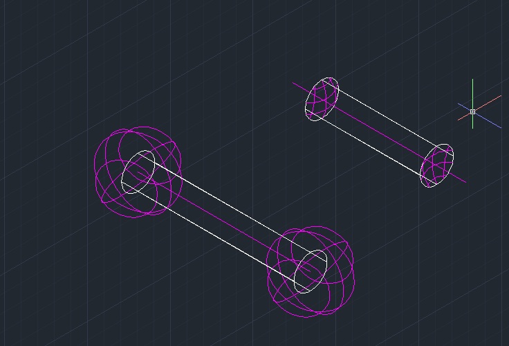

method:
- 2 spheres at the desired distance
- 1 line between their centers
- 1 cylinder of desired radius and height equal to the distance between the two spheres' centers
-subtract both spheres from cylinder
-keep the line uniting the centers of the spheres that have been subtracted from the cylinder
This line+concave heads cylinder is the atom of the structure that I can replicate and use with ease for connecting spheres and knowing that the intersection is ALWAYS on the sphere surface and is a perfect circle.

I would build the cylinder from the center of that sphere, adjust the UCS with the origin in the said center and one axis aligned with the axis of the cylinder and after will be very easy to just move the cylinder or to cut it (SLICE command) at the required plane.
