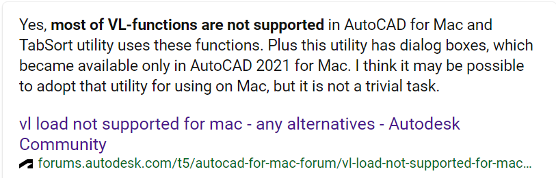

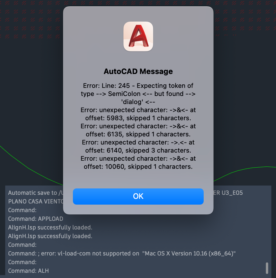

mmxxzz Posted September 12, 2022 Share Posted September 12, 2022 Currently getting this error (AutoCAD for Mac 2022) Quote Link to comment Share on other sites More sharing options...
BIGAL Posted September 13, 2022 Share Posted September 13, 2022 (edited) "error: Vl-load-com not supported on MAC" is your problem if I remember correct the VL functions do not work on the Mac version. So sorry code will not work. Edited September 13, 2022 by BIGAL 1 Quote Link to comment Share on other sites More sharing options...
