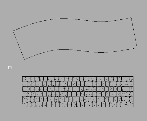

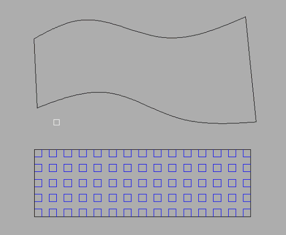

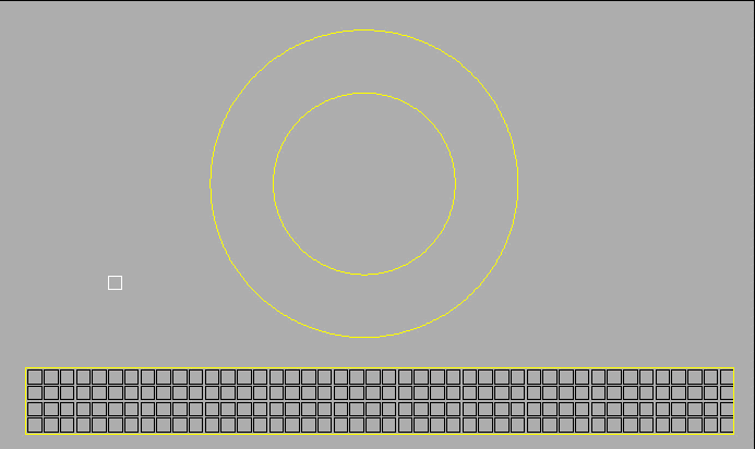

the lisp, anticipated with two images here and here, aligns between two curves the hatch elements and creates a block containing the lines of the new geometry.
The original shape of the hatch shall be a rectangle, an isosceles triangle or an isosceles trapezoid.
In case of large hatches is recommended to divide it into portions, any case it is better to try with small hatches to verify the time required for processing, in according to PC performances, too.
Not all hatches are suitable for processing.
I hope it works well and there are no problems.

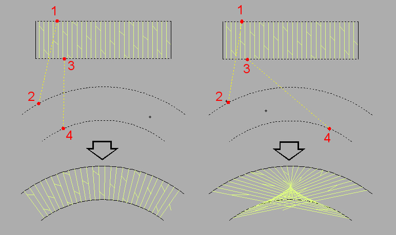

this is really cool lisp!!! i start using them but fail with one pattern. Please see attached file
is it possible to make a short description how do you calculate all these points? any source where i can read about this?

@ kruuger
First case.
I already said that not all hatches are suitable for processing.
Are adapted the individual lines (start/end point), you will get better results with short lines or transverse (if long).
Second case.
Attention to the selection point.

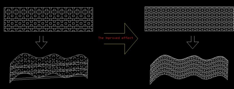

Hi,GP,Thanks for your wonderful routine. I have some improvement for you code,It fix some BUG for hatch line is too long.
AlignH.lsp
  • Like 2
@SEANT
You are my muse.
@Gu_xl
Perfect.
The problem was on longitudinal long lines.
You have brilliantly solved.
