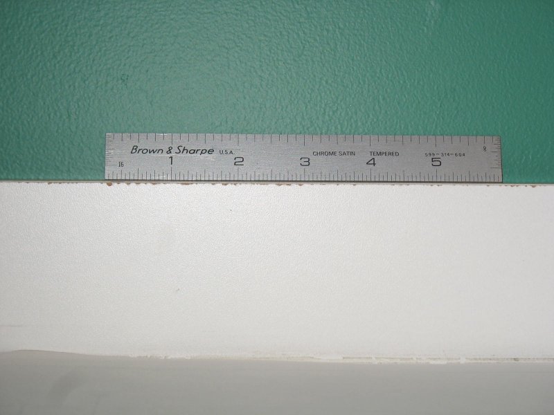

ReMark Posted October 10, 2012 Posted October 10, 2012 I think this might be referred to as a machinist's ruler if I am not mistaken. JDM will surely correct me if I am wrong. Note that across the bottom it is divided into sixteenths. There are longer lines for every eighth of an inch. Quote

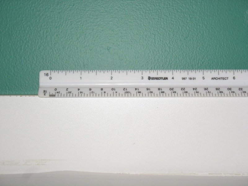

ReMark Posted October 10, 2012 Posted October 10, 2012 One end of an "Architect" scale. That is sixteenths on the top scale. Quote

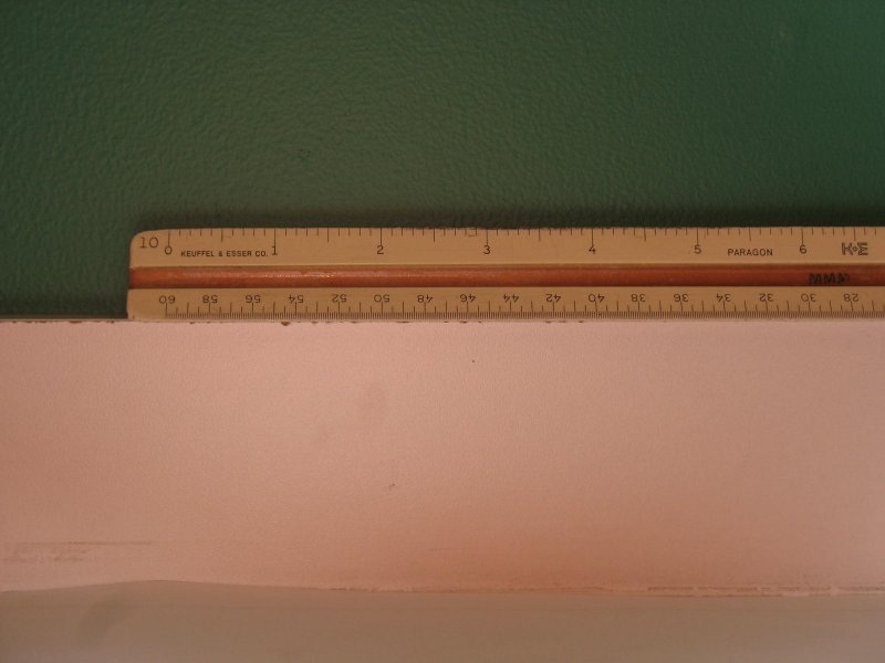

ReMark Posted October 10, 2012 Posted October 10, 2012 One end of an "Engineer" scale. The top scale is divided into tenths. It could be used to measure distances on a drawing where the scale was 1"=10' or even 1"=100' (mentally add a "0"). So, of the three images I've shown, which one did you use to measure a distance on the plan of the villa provided by your professor? Quote
