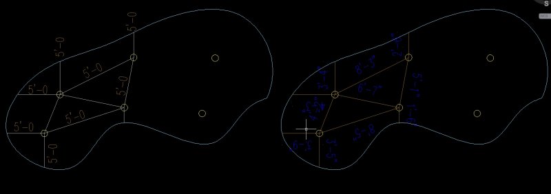

just trying to show more in depth of what i need. the example on the left i made by hand to show exactly what i would like. the one on the right is showing the exact way that the autodim command works. does this make sense?

so i could draw the lines in thats not the biggest issue. the only issue im having is that the text with the autodim command is messy and not always upright or close enough to the line.
I drew the lines between the circles.
AutoDim put in the dimensions.
I modified the routine to meet your needs for now , which is would make and put the dimension entity on the line exactly besides that would delete
the selected line since that you draw them only to run the code .

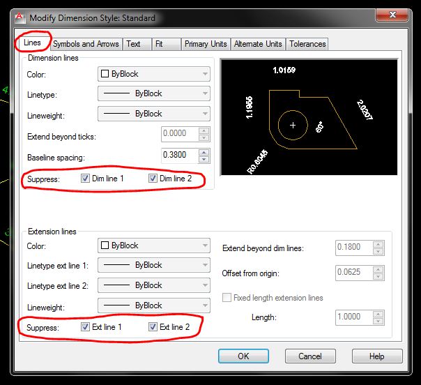

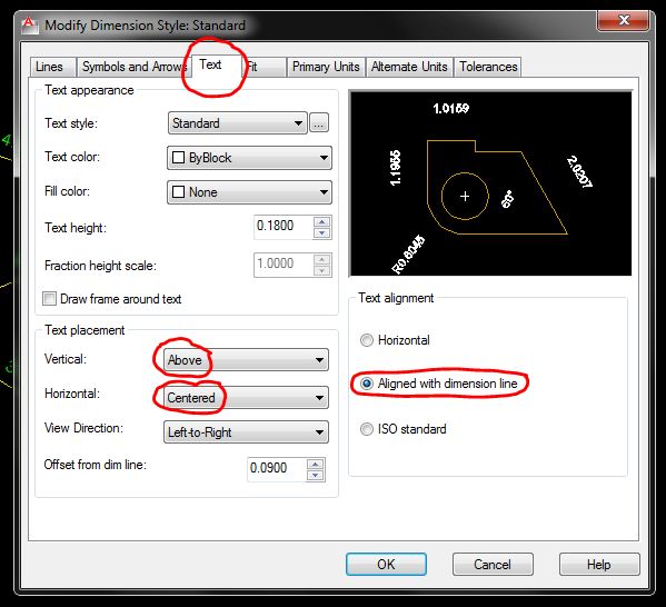

Ryan: The text position relative to the line is controlled via two options in the DimStyle dialog box. I think "how" the lines are drawn may address your comment re: messy.

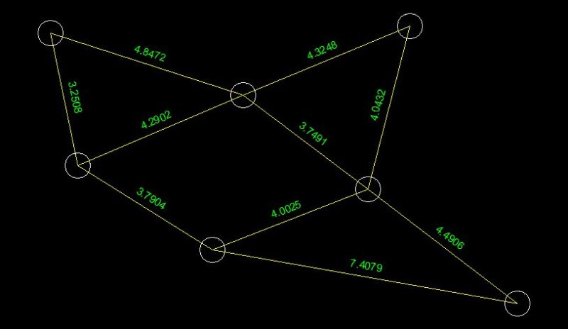

thats how it came out for you? that looks good, i know its spread out more than most drawings i would have, but it seems to be coming out better than mine are.
Yes, that is how it came out for me. The difference is I tweaked a couple of DimStyle settings and I paid close attention to how I drew my interconnecting lines.
i just used your exact lsp you made and that is perfect!!!
And here are the other changes I made.
Then I just made sure to draw all my connecting lines from left to right.
