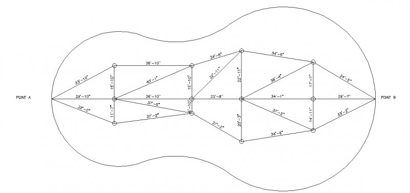

ryan osmun Posted October 9, 2012 Author Posted October 9, 2012 i could include the lines if when i used the function it would just show the length of the line and not any arrows or additional lines. Quote
Tharwat Posted October 9, 2012 Posted October 9, 2012 ryan osmun said: i could include the lines if when i used the function it would just show the length of the line and not any arrows or additional lines. Just make a new Dimension style and adjust it as best as you want it to look like and make it current and after that run the code . Quote
ReMark Posted October 9, 2012 Posted October 9, 2012 So your code reads the current dimension style and emulates it? Quote
Tharwat Posted October 9, 2012 Posted October 9, 2012 ReMark said: So your code reads the current dimension style and emulates it? Yes , that's correct . Quote

ryan osmun Posted October 9, 2012 Author Posted October 9, 2012 ok so doing it like this would work, but let me ask you. when i dim it normal i dont have a line at all, the line comes up with the dimension. is there any way you could do this with out me drawing the lines? Quote
ReMark Posted October 9, 2012 Posted October 9, 2012 The routine requires the user to select the lines that are being dimensioned. Unfortunately you are not dimensioning lines, per se, but circle-to-circle center points. I have to wonder how accurate this can be in the field or is this for an "as built"? If one "head" is off, for whatever reason, it makes dimensions from it to the adjacent heads inaccurate. Quote
ryan osmun Posted October 9, 2012 Author Posted October 9, 2012 it would have to be accurate. im not sure what you mean when you say if one head is off, like if it is placed wrong in the field, everything will be off? Quote
ReMark Posted October 9, 2012 Posted October 9, 2012 That's exactly what I mean. Maybe the tech reads the tape measure incorrectly, or reads the plan wrong and transposes two numbers. Don't tell me it hasn't happened. Quote
ryan osmun Posted October 9, 2012 Author Posted October 9, 2012 it does happen, but this is the way i have been doing it for a long time and am not quite sure on another way to dimension it to get the dims for everything in a simplified way. Quote
ReMark Posted October 9, 2012 Posted October 9, 2012 There's no "baseline" when the sprinkler heads are located in the field? Quote

RobDraw Posted October 10, 2012 Posted October 10, 2012 I used to draft for an in-ground pool company. A lot of the pools had self cleaning systems with pop-up heads. Not much different from that layout the OP showed us. The pool and the system were based off of two given points. This is one way we would dimension the location of the heads. Quote
Tharwat Posted October 10, 2012 Posted October 10, 2012 The question still on . Are these circles connected with each others by lines or these lines are the dimension lines only ? Quote
RobDraw Posted October 10, 2012 Posted October 10, 2012 I did that with dimensions only. Faster than drawing lines and then dimensioning them. Quote
ReMark Posted October 10, 2012 Posted October 10, 2012 Re: OP's drawing. I believe there would be no lines in the drawing connecting the circles. The lines he does show would be dimension lines. Quote
ryan osmun Posted October 10, 2012 Author Posted October 10, 2012 ReMark said: Re: OP's drawing. I believe there would be no lines in the drawing connecting the circles. The lines he does show would be dimension lines. this is correct. the best way i can think to put it would be when i use the autodim lisp command, i would want to select all of the circles with no lines in between them and have the command create the dim lines in between all of the circles. Quote
