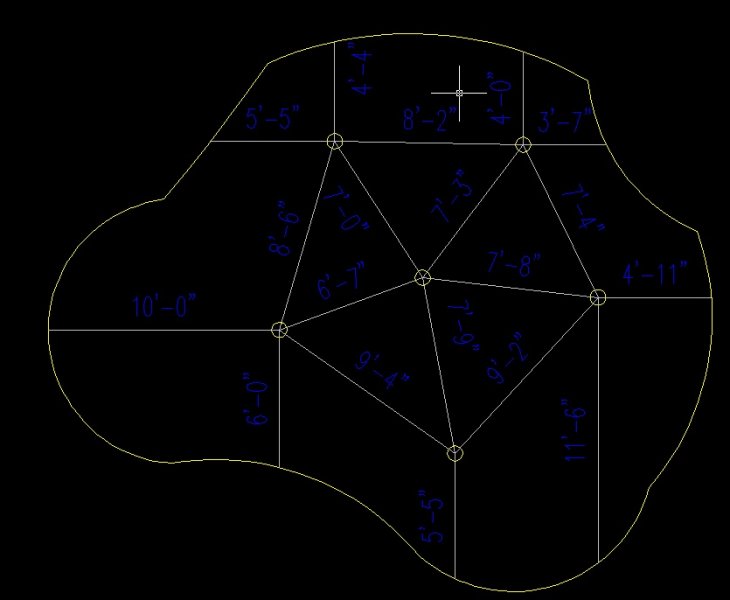

ryan osmun Posted October 8, 2012 Posted October 8, 2012 i install sprinkler heads and am trying to find a way to dimension them like the picture but with only a command instead of dimensioning between every single head/ circle manually. Quote

ReMark Posted October 9, 2012 Posted October 9, 2012 No one said you were restricted to one site. How about we change the question instead, as Kyle suggested, and ask if anyone knows of a lisp routine that will dimension lines as shown in the posted image? It appears you do not want arrowheads or extension lines just dimensions which shouldn't be a problem. Now the other question is are the lines that you show (from center-to-center of each circle) going to be a part of the drawing to begin with or do they also need to be drawn? The more information you can provide the better the answer, and maybe even the lisp routine, will be. Are we all on the same page now? Did you ever follow through with Kyle regarding the lisp routine that he posted an image for? Quote
ReMark Posted October 9, 2012 Posted October 9, 2012 (edited) I saved you the trouble and had Kyle send me a copy of the lisp routine he found. It was authored by forum member Tharwat and dated 06.Dec.2011. It is attached to this post as AutoDim.lsp.txt. To use it you will first have to rename it to AutoDim.lsp then load it via the AutoCAD command APPLOAD. To run it type AutoDim at the command line. Note that it works with lines. That means you will have to have a line that goes from center of circle to center of circle. Yes, I know this isn't exactly what you were looking for but maybe you will get lucky and Tharwart will offer up a modified version of the routine if you ask nicely. AutoDim.lsp.txtFetching info... Edited October 9, 2012 by ReMark Corrected spelling error Quote
ryan osmun Posted October 9, 2012 Author Posted October 9, 2012 ReMark said: I saved you the trouble and had Kyle send me a copy of the lisp routine he found. It was authored by forum member Tharwart and dated 06.Dec.2011. It is attached to this post as AutoDim.lsp.txt. To use it you will first have to rename it to AutoDim.lsp then load it via the AutoCAD command APPLOAD. To run it type AutoDim at the command line. Note that it works with lines. That means you will have to have a line that goes from center of circle to center of circle. Yes, I know this isn't exactly what you were looking for but maybe you will get lucky and Tharwart will offer up a modified version of the routine if you ask nicely. [ATTACH]37711[/ATTACH] WOW! thanks alot that is really close to what i wanted. your instructions were perfect to. i will have see about asking him to do that. do i just type his name in to search for him? Quote

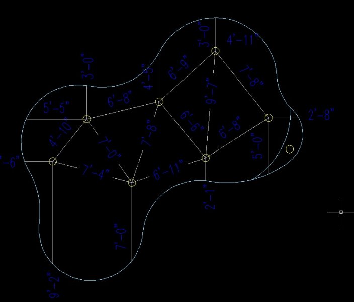

ryan osmun Posted October 9, 2012 Author Posted October 9, 2012 I would like the dimensions to show like this. the ones to the edges of the perimeter i can do manually if that wouldnt be possible to do. but for all of the circles connected in the area of the perimeter they would have to look like they do in this pic. the reason being that some of the perimeters are huge and will have a ton of circles inside and could get confusing the way the lisp is set up right now. again i would like to thank all of you guys this will help me out tremendously. if i can do anything please just let me know. Quote
ReMark Posted October 9, 2012 Posted October 9, 2012 Please answer this one question: Are the lines going from center of circle to center of circle already included as part of the drawing or would they have to be created? Quote
Tharwat Posted October 9, 2012 Posted October 9, 2012 Do you have lines connected to each circle and to the boundary as it is shown in the last image ? If yes , you can use the upload lisp by Remark with a few modifications to put the dimension on the lines without a gap , otherwise to make the dimensions from circle to circle and a few of the them to the boundary , it is not that easy to handle , or at least to me - Frankly . Quote
ryan osmun Posted October 9, 2012 Author Posted October 9, 2012 ReMark said: Please answer this one question: Are the lines going from center of circle to center of circle already included as part of the drawing or would they have to be created? they are not already included as part of the drawing Quote
